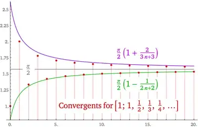

Matrix Representation of Convergents
One method to compute the convervgents of continued fractions uses matrices: if $[c_0;c_1,c_2,\dots,c_n]=\frac{p_n}{q_n}$, then $$ \begin{bmatrix}0&1\\1&0\end{bmatrix} \prod_{k=0}^n\begin{bmatrix}0&1\\1&c_k\end{bmatrix} =\begin{bmatrix}p_{n-1}&p_n\\q_{n-1}&q_n\end{bmatrix}\tag1 $$ Since $c_0=1$, and for $k\ge1$, $c_k=\frac1k$ we get $$ \begin{bmatrix}1&1\\0&1\end{bmatrix} \prod_{k=1}^n\begin{bmatrix}0&1\\1&\frac1k\end{bmatrix} =\begin{bmatrix}p_{n-1}&p_n\\q_{n-1}&q_n\end{bmatrix}\tag2 $$
Closed Form
We will show by induction that $$ \begin{bmatrix}1&1\\0&1\end{bmatrix} \prod_{k=1}^{2n}\begin{bmatrix}0&1\\1&\frac1k\end{bmatrix} =\begin{bmatrix} \frac{4^n}{\binom{2n}{n}}&\frac{4^n}{\binom{2n}{n}}\\ \frac{\binom{2n}{n}2n}{4^n}&\frac{\binom{2n}{n}(2n+1)}{4^n} \end{bmatrix}\tag3 $$ Note that $(3)$ is true for $n=0$. Assume $(3)$ is true for some $n$, then $$ \begin{bmatrix} \color{#C00}{\frac{4^n}{\binom{2n}{n}}}&\color{#C00}{\frac{4^n}{\binom{2n}{n}}}\\ \color{#090}{\frac{\binom{2n}{n}2n}{4^n}}&\color{#090}{\frac{\binom{2n}{n}(2n+1)}{4^n}} \end{bmatrix} \begin{bmatrix} 0&1\\1&\frac1{2n+1} \end{bmatrix} =\begin{bmatrix} \frac{4^n}{\binom{2n}{n}}&\color{#C00}{\frac{4^{n+1}}{\binom{2n+2}{n+1}}}\\ \frac{\binom{2n}{n}(2n+1)}{4^n}&\color{#090}{\frac{\binom{2n}{n}(2n+1)}{4^n}} \end{bmatrix}\tag4 $$ The left column of the result is easy, the right column top element is $$ \begin{align} \color{#C00}{\frac{4^n}{\binom{2n}{n}}}\cdot1+\color{#C00}{\frac{4^n}{\binom{2n}{n}}}\cdot\frac1{2n+1} &=\frac{4^n}{\binom{2n}{n}}\frac{2n+2}{2n+1}\tag{5a}\\ &=\frac{4^n}{\binom{2n}{n}}\frac{(2n+2)^2}{(2n+1)(2n+2)}\tag{5b}\\ &=\color{#C00}{\frac{4^{n+1}}{\binom{2n+2}{n+1}}}\tag{5c} \end{align} $$ the right column bottom element is $$ \begin{align} \color{#090}{\frac{\binom{2n}{n}2n}{4^n}}\cdot1+\color{#090}{\frac{\binom{2n}{n}(2n+1)}{4^n}}\cdot\frac1{2n+1} &=\color{#090}{\frac{\binom{2n}{n}(2n+1)}{4^n}}\tag6 \end{align} $$ We can continue $$ \begin{bmatrix} \color{#C00}{\frac{4^n}{\binom{2n}{n}}}&\color{#C00}{\frac{4^{n+1}}{\binom{2n+2}{n+1}}}\\ \color{#090}{\frac{\binom{2n}{n}(2n+1)}{4^n}}&\color{#090}{\frac{\binom{2n}{n}(2n+1)}{4^n}} \end{bmatrix} \begin{bmatrix} 0&1\\1&\frac1{2n+2} \end{bmatrix} =\begin{bmatrix} \frac{4^{n+1}}{\binom{2n+2}{n+1}}&\color{#C00}{\frac{4^{n+1}}{\binom{2n+2}{n+1}}}\\ \frac{\binom{2n}{n}(2n+1)}{4^n}&\color{#090}{\frac{\binom{2n+2}{n+1}(2n+3)}{4^{n+1}}} \end{bmatrix}\tag7 $$ The left column of the result is easy, the right column top element is $$ \begin{align} \color{#C00}{\frac{4^n}{\binom{2n}{n}}}\cdot1+\color{#C00}{\frac{4^{n+1}}{\binom{2n+2}{n+1}}}\cdot\frac1{2n+2} &=\frac{4^n}{\binom{2n}{n}}+\frac{4^n}{\binom{2n}{n}}\frac4{\frac{(2n+1)(2n+2)^2}{(n+1)^2}}\tag{8a}\\ &=\frac{4^n}{\binom{2n}{n}}+\frac{4^n}{\binom{2n}{n}}\frac1{2n+1}\tag{8b}\\ &=\frac{4^n}{\binom{2n}{n}}\frac1{\frac{(2n+1)(2n+2)}{(2n+2)^2}}\tag{8c}\\ &=\color{#C00}{\frac{4^{n+1}}{\binom{2n+2}{n+1}}}\tag{8d} \end{align} $$ the right column bottom element is $$ \begin{align} \color{#090}{\frac{\binom{2n}{n}(2n+1)}{4^n}}\cdot1+\color{#090}{\frac{\binom{2n}{n}(2n+1)}{4^n}}\cdot\frac1{2n+2} &=\frac{\binom{2n}{n}(2n+1)}{4^n}\frac{(2n+2)(2n+3)}{(2n+2)^2}\tag{9a}\\ &=\color{#090}{\frac{\binom{2n+2}{n+1}(2n+3)}{4^{n+1}}}\tag{9b} \end{align} $$ $(4)$ and $(7)$ show that $(3)$ is true for $n+1$.
Estimating the Convergents
$(1)$ and $(3)$ show that $$ \frac{p_{2n-1}}{q_{2n-1}}=\frac1{2n}\left(\frac{4^n}{\binom{2n}{n}}\right)^2\tag{10} $$ $$ \frac{p_{2n}}{q_{2n}}=\frac1{2n+1}\left(\frac{4^n}{\binom{2n}{n}}\right)^2\tag{11} $$ $(10)$ and $(11)$ can be unified as $$ \frac{p_n}{q_n}=\frac1{n+1}\left(\frac{4^{\lceil n/2\rceil}}{\binom{2\lceil n/2\rceil}{\lceil n/2\rceil}}\right)^2\tag{12} $$ $(10)$ from this answer says that $$ \pi\left(n+\tfrac14\right)\le\left(\frac{4^n}{\binom{2n}{n}}\right)^2\le\pi\left(n+\tfrac13\right)\tag{13} $$ Since $\frac n2\le\lceil n/2\rceil\le\frac{n+1}2$, $(12)$ and $(13)$ show that $$ \frac\pi2\left(1-\frac1{2n+2}\right)\le\frac{p_n}{q_n}\le\frac\pi2\left(1+\frac2{3n+3}\right)\tag{14} $$ which, by the Squeeze Theorem, says that $$ \bbox[5px,border:2px solid #C0A000]{\lim_{n\to\infty}\left[1;1,\tfrac12,\tfrac13,\dots,\tfrac1n\right]=\frac\pi2}\tag{15} $$ enter image description here
Wallis Product
The Wallis Product for $\pi$ is $$ \frac\pi2=\prod_{k=1}^\infty\frac{4k^2}{4k^2-1}\tag{16} $$ Consider the partial products $$ \begin{align} \prod_{k=1}^n\frac{4k^2}{4k^2-1} &=\prod_{k=1}^n\frac{2k}{2k+1}\frac{2k}{2k-1}\tag{17a}\\ &=\prod_{k=1}^n\frac{2k-1}{2k+1}\left(\frac{2k}{2k-1}\right)^2\tag{17b}\\ &=\frac1{2n+1}\left(\prod_{k=1}^n\frac{(2k)^2}{(2k-1)2k}\right)^2\tag{17c}\\ &=\frac1{2n+1}\left(\frac{4^n}{\binom{2n}{n}}\right)^2\tag{17d} \end{align} $$ Note the similarity between $(11)$ and $\text{(17d)}$.
robjohn
  • 353,833
    Pretty neat proof! I like how the squeeze theorem shows how useful is to separate odd and even terms, I put some terms on wolfram and try also changing 1/2,1/3 by 1/k+1,1/k+3 for example and other things but I can't see how you realized the fornula for the 2n matrix – Dabed Dec 23 '20 at 16:24
  • and in the link you use that $(\frac{n+\frac12}{n+1})^2 \le\frac{n+\frac13}{n+\frac43}$ which cross multiplying and resting terms checks out but even though it looks simple I don't have idea either how you realized this was the inequality you needed – Dabed Dec 23 '20 at 16:32
    The entries in the $2\times2$ matrix were deduced from looking at the values of $p_n$ and $q_n$ in the convergents of the continued fraction and looking at the values of Wallis' Product. – robjohn Dec 23 '20 at 16:43
    In the link, what one wants is to get a telescoping product, that is where the numerator and denominator differ by $1$, as in $\frac{n+1/3}{n+4/3}$. Since the numerator and denominator in $\frac{n+1/2}{n+1}$ differ by $\frac12$, squaring is indicated. I just needed to figure out that $$\frac{n+1/4}{n+5/4}\le\left(\frac{n+1/2}{n+1}\right)^2\le\frac{n+1/3}{n+4/3}$$ – robjohn Dec 23 '20 at 16:52
  • Thanks for your edit it really helped me understand what I couldn't and I wouldn't have realized either the Wallis product was behind this answer as well if you didn't mentioned it, great visualization too, I surely will come back to let the answers sink more on my head – Dabed Dec 25 '20 at 19:27
