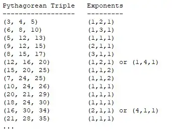

For example, the triple
$(12, 16, 20)$
has these exponents:
$(12^1, 4^2, 20^1)$ or $(12^1, 2^4, 20^1)$
denoted by
$(1,2,1)$ or $(1,4,1)$
Here are more triples (ignore simple (1,1,1) cases):
fix-trips
I ran millions of triple tests looking for two identical exponents > 1, but found no matches.
