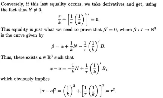

conversely this turns out
$\textbf{imagge attached}$
