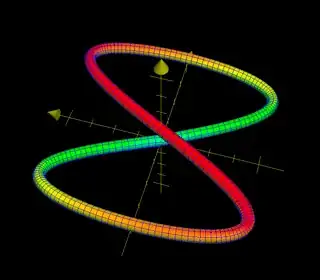

Again, as a smooth manifold, the figure eight is just $S^1$, so we need to specify a map $f\colon S^1\to \Bbb R^2$. Really, we want to imagine first embedding $S^1$ into $\Bbb R^3$ so that it looks like a figure eight from above. Here is an example, where $S^1$ is shown as a tube for the sake of visualizing.
a fattened embedding of S^1 in R^3

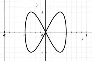

Now if we project down to the $xy$ plane, we get a map $S^1\to \Bbb R^2$ whose image is shown below.
the image of an immersion of S^1 in R^2
One can show that this is an immersion, meaning that for any $p\in S^1$, the differential map $df_p\colon T_pS^1\to T_{f(p)}\Bbb R^2$ is injective. However, $f$ itself is not even injective! There are clearly two points in $S^1$ which both land on the origin in $\Bbb R^2$. So $f$ is not a bijection onto its image, and therefore not a homeomorphism onto its image (embedding).

This language doesn't make sense, but you probably mean the following: for any open set $U\subset\Bbb R^2$ containing the origin, there is no homeomorphism between $U\cap f(S^1)$ and a neighborhood of $S^1$. This is more difficult to prove; I would probably use algebraic topology.
To summarize, there are distinct questions one could ask here:
  1. Is there an embedding $S^1\to \Bbb R^2$? (Yes.)
  2. Is the map $f\colon S^1\to \Bbb R^2$ an embedding? (No because $f$ is not injective.)
  3. Is there an embedding from $S^1$ to $f(S^1)$ (topologized as a subset of $\Bbb R^2$)? (No but this is less immediate.)
