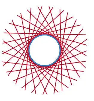

Secondly, even if you embed the tangent spaces in a common universe, e.g. by embedding the manifold inside some Euclidean space, then you lose crucial information by taking a regular union, since the line between tangent vectors and points becomes blurred and points living in distinct tangent spaces may get identified. For example, consider the tangent bundle of the circle embedded in $\Bbb{R}^2$, as in the following picture:tangent bundle
By taking a regular union, you get the subset of $\Bbb{R}^2$ consisting of all the points in red as your tangent bundle. But then all the points which lie on multiple lines "forget" which tangent space they belong to. For example, the point $(1,1)$ lies on the tangent space at $(1,0)$ as well as the tangent space at $(0,1)$. Therefore you lose the canonical surjection $\bigcup_p T_pM \to M$ which is used, among many other things, to endow the tangent bundle with a manifold structure. Disaster!
