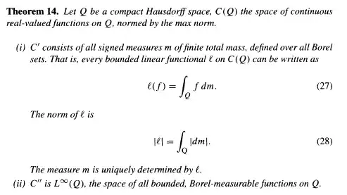

2) I'm also aware that $(C(X)^*)^*$, the dual of the dual, coincide with the set of bounded Borel measurable functions $F:X\rightarrow\mathbb{R}$ (source: P. Lax, Functional Analysis).
UPDATE Landscape provided a counterexample in the comments. My source was: P. Lax "Functional Analysis" 2002, Page 82, Theorem 14(ii). I guess this might be a mistake, perhaps fixed in some errata somewhere.
New question: C.f. Landscape's example, let $g_A$ be the extension (given by Hahn-Banach) of $f_A$ to $C([0,1])^{**}$. Looking at $g_A$ as a function $X\rightarrow\mathbb{R}$, $g_A$ must satisfy by construction the equation $\int_{[0,1]}g_A \ d \ \delta_x= 1$ if $x\in A$ and $0$ otherwise. This seems to imply that $g_A$ is the characteristic function of $A$. Hence not Borel if $A$ is not Borel.
Thus, $g_A$ as a function $(X\rightarrow\mathbb{R})$ is uniquely determined by the construction starting from $f_A$. But is it $g_A$ as an element of $C([0,1])^{**}$ uniquely determined? If so, it looks to me we would have a reasonably well defined notion of integration for non-measurable sets.
Thanks!
Screen shot of Lax's theorem 14 on page 82:
Lax, Theorem 14, page 82

  • Space $C(X)^{**}$ contains the space of bounded Borel functions. But it contains other objects in addition. What is the exact quote in Lax? Is there an on-line errata for that text? – GEdgar May 15 '13 at 13:48
  • Page 82, Theorem 14(ii). "Let Q be a compact Hausdorff space, C(Q) the space of continuous real valued functions on Q normed by the max norm. Then (ii) $C^{\prime\prime}$ is $L^\infty(Q)$, the space of all bounded Borel measurable functions on Q".

  • I added a screen shot with the precise statement of the theorem in Lax to avoid further speculation. @N.S. No it is not true (assuming you mean the dual of $C_c(X)$ in your question). The dual space of $(X^\ast, \mathrm{weak}^\ast)$ is $X$ itself. See this answer for a proof. – Martin May 15 '13 at 18:51

  • It says the proof is in Appendix A, but I think that is only the proof of (i). – GEdgar May 15 '13 at 19:24
