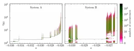

This also holds empirically: Complex systems show larger chaotic bands, i.e., parameter regimes in which they are chaotic. For example, consider the following figure from this paper (which I co-authored):
bifurcation diagrams of simple and complex variant of system
Systems B and A are coupled oscillator networks designed in the same way, except that System B has more components or dimensions, respectively. Whenever you see a vertical band in the diagram, you have chaos for that value of the control parameter $a$. As you can see, the chaotic regions are considerably larger for the more complex system.
