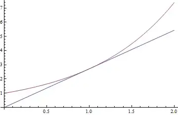

Which means in simple language that the gradient of the curve at a point is proportional to the value of the curve at that point. For instance, at the point $(1,e)$, the gradient of the tangent (shown as blue in the graph below) to the curve $y=e^{x}$ (shown in red) is $e$.
