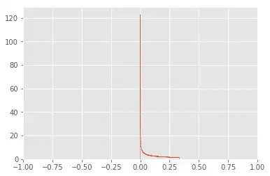

First I was thinking somehow to compute this probability using the conditional probability for $X_1^2|X_1^2+X_2^2.$ I made some experiments and found that the histogram for $Pr(X_1^2<1/3|X_1^2+X_2^2<2/3)$ is the following
