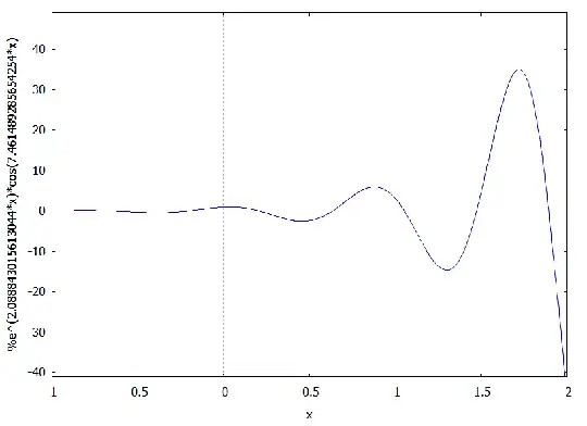

Let $\lambda = \alpha + \beta i \in \mathbb{C}$ be any root of the equation $\lambda = e^{\lambda} - 1$ subject to $\beta \ge 0$ and $\delta$ any real number, then $$f(x) = \Re( e^{\lambda x + i\delta} ) = e^{\alpha x} \cos(\beta x + \delta)\tag{*}$$ will be a $C^{\infty}$ solution for the functional equation $f'(x) = f(x+1) - f(x)$.
For example, $\lambda = e^{\lambda} -1 $ has a root at $\sim 2.088843015613044 + 7.461489285654254 i$.
This gives us following $C^{\infty}$ solution:
$$f(x) \sim e^{ 2.088843015613044\,x}\,\cos(7.461489285654254\,x)$$
Yet another graph for functional equations
Other solutions can be constructed by forming linear combination of solutions of the form in $(*)$. Please note that $\lambda = e^{\lambda} - 1$ has a double root at $\lambda = 0$, there are two solutions at $\lambda = 0$ which one can use:
$$ \Re( e^{\lambda x} )\Big|_{\lambda = 0} = 1 \quad\quad\text{ and }\quad\quad \frac{\partial}{\partial \lambda} \Re( e^{\lambda x} )\Big|_{\lambda = 0} = x $$
