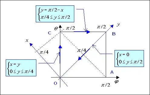

The following illustrates an approach that looks promising, but that I could not yet complete: wish you and the community here might help to finalize it.
Starting from the integrand $$ f(\theta ,\varphi ) = {{\theta \cot \theta - \varphi \cot \varphi } \over {\cos \theta - \cos \varphi }} = {{\theta {{\cos \theta } \over {\sin \theta }} - \varphi {{\cos \varphi } \over {\sin \varphi }}} \over {\cos \theta - \cos \varphi }} = f(\varphi ,\theta ) $$ it's structure suggests the idea that Green's Theorem might be applied.
Formulated as above, it is difficult to find the needed potential function.
But applying the transformation $$ \left\{ \matrix{ \theta = x + y \hfill \cr \varphi = y - x \hfill \cr} \right.\quad \Leftrightarrow \quad \left\{ \matrix{ x = {{\theta - \varphi } \over 2} \hfill \cr y = {{\theta + \varphi } \over 2} \hfill \cr} \right. $$ we get $$ \eqalign{ & g(x,y) = f(x + y,\;y - x) = \cr & = {{\left( {y - x} \right){{\cos \left( {y - x} \right)} \over {\sin \left( {y - x} \right)}} - \left( {y + x} \right){{\cos \left( {y + x} \right)} \over {\sin \left( {y + x} \right)}}} \over {\cos \left( {y - x} \right) - \cos \left( {y + x} \right)}} = \cr & = {{y\left( {{{\cos \left( {y - x} \right)} \over {\sin \left( {y - x} \right)}} - {{\cos \left( {y + x} \right)} \over {\sin \left( {y + x} \right)}}} \right) - x\left( {{{\cos \left( {y - x} \right)} \over {\sin \left( {y - x} \right)}} + {{\cos \left( {y + x} \right)} \over {\sin \left( {y + x} \right)}}} \right)} \over {2\sin x\sin y}} = \cr & = {{y\sin \left( {2x} \right) - x\sin \left( {2y} \right)} \over {2\sin x\sin y\sin \left( {y - x} \right)\sin \left( {y + x} \right)}} = \cr & = y{{\sin \left( {2x} \right)} \over {2\sin x\sin y\sin \left( {y - x} \right)\sin \left( {y + x} \right)}} - x{{\sin \left( {2y} \right)} \over {2\sin x\sin y\sin \left( {y - x} \right)\sin \left( {y + x} \right)}} = \cr & = y{{\cos x} \over {\sin y\left( {\sin ^2 y\cos ^2 x - \cos ^2 y\sin ^2 x} \right)}} - x{{\cos y} \over {\sin x\left( {\sin ^2 y\cos ^2 x - \cos ^2 y\sin ^2 x} \right)}} = \cr & = y{{\cos x} \over {\sin y\left( {\cos ^2 x - \cos ^2 y} \right)}} - x{{\cos y} \over {\sin x\left( {\cos ^2 x - \cos ^2 y} \right)}} = \cr & = g( - x,y) \cr} $$
Putting: $$ \eqalign{ & M(x,y) = - {y \over {2\sin ^2 y}}\ln \left( {{{ - \sin x + \sin y} \over {\sin x + \sin y}}} \right) \cr & L(x,y) = {x \over {2\sin ^2 x}}\ln \left( {{{ - \sin x + \sin y} \over {\sin x + \sin y}}} \right) \cr} $$ then we have the expression required for applying the Green's theorem $$ g(x,y) = {\partial \over {\partial x}}M(x,y) - {\partial \over {\partial y}}L(x,y) $$
With the help of this sketch
Int_Cot_1
we have $$ \eqalign{ & I = \int_0^{\pi /2} {\int_0^{\pi /2} {f(\theta ,\varphi )\,d\varphi \,d\theta } } = \cr & = \int\!\!\!\int\limits_{square} {f(\varphi ,\theta )\,d\varphi \,d\theta } = 2\int\!\!\!\int\limits_{triang} {f(\varphi ,\theta )\,d\varphi \,d\theta } = \cr & = 4\int\!\!\!\int\limits_{triang} {g(x,y)\,dx\,dy} = 4\int\!\!\!\int\limits_{triang} {\left( {{\partial \over {\partial x}}M - {\partial \over {\partial y}}L} \right)\,dx\,dy} = \cr & = 4\oint\limits_{triang} {Ldx + Mdy} \cr} $$ that is $$ \eqalign{ & {I \over 4} = \oint\limits_{triang} {Ldx + Mdy} = \cr & = \left( \matrix{ \int_{y = 0}^{\pi /4} {\left( {L\left( {y,y} \right) + M(y,y)} \right)dy} + \hfill \cr + \int_{y = \pi /4}^{\pi /2} {\left( { - L\left( {\pi /2 - y,y} \right) + M(\pi /2 - y,y)} \right)dy} + \hfill \cr - \int_{y = 0}^{\pi /2} {M(0,y)dy} \hfill \cr} \right) = \cr & = I_{\,1} + I_2 + I_3 \cr } $$
Now $$ I_3 = - \int_{y = 0}^{\pi /2} {M(0,y)dy} = \int_{y = 0}^{\pi /2} {{y \over {2\sin ^2 y}}\ln \left( {{{\sin y} \over {\sin y}}} \right)dy} = 0 $$
$I_{\,1}$ instead, is not null as it might appear.
If the path is taken to approach $y=x$ while maintaining positive the difference $y-x$ then a numerical computation gives a value of $\approx -1.233688 \ldots$, which together with the computation of $I_{\, 2}$ returns the expected value for $I$.
I am blocked at this point: analytically establish and justify the path for $I_{\, 1}$ and find a close expression for it and for $I_{\, 2}$.

[![image 1][1]][1] \begin{align*} \bbox[#EFF,15px,border:2px solid blue]{ \begin{split} I&=\int_0^{\frac{\pi}{2}}\!\!\int_0^{\frac{\pi}{2}}f(x,y)\mathrm{d}x\mathrm{d}y=2\int_0^{\frac{\pi}{2}}\!\!\int_y^{\frac{\pi}{2}}f(x,y)\mathrm{d}x\mathrm{d}y\\ &=2\int_0^{\frac{\pi}{4}}\!\!\int_v^{\frac{\pi}{2}-v}g(u,v)\left|\dfrac{\partial(x,y)}{\partial(u,v)}\right|\mathrm{d}u\mathrm{d}v\quad\,\left( \begin{split} x=u+v\\ y=u-v \end{split}\right)\\ &=4\int_0^{\frac{\pi}{4}}\!\!\int_{v}^{\frac{\pi}{2}-v}g(u,v)\mathrm{d}u\mathrm{d}v\\ &=4\lim\limits_{\varepsilon\to0}\int_0^{\frac{\pi-\varepsilon}{4}}\!\!\int_{v+\frac{\varepsilon}{2}}^{\frac{\pi}{2}-v}g(u,v)\mathrm{d}u\mathrm{d}v\\ &=4\lim\limits_{\varepsilon\to0}\kern{23pt}\bigcirc\kern{-29.5pt}\int\limits_{\overline{AB}+\overline{BC}+\overline{CA}}P_0(u,v)\mathrm{d}u+Q_0(u,v)\mathrm{d}v\\ \end{split} } \end{align*}\ [![image 2][2]][2] \begin{align*} I_1&=\lim\limits_{\varepsilon\to0}\kern{6pt}\bigcirc\kern{-12pt}\int\limits_{\overline{AB}}P_0(u,v)\mathrm{d}u+Q_0(u,v)\mathrm{d}v\\ I_2&=\lim\limits_{\varepsilon\to0}\kern{6pt}\bigcirc\kern{-12pt}\int\limits_{\overline{BC}}P_0(u,v)\mathrm{d}u+Q_0(u,v)\mathrm{d}v\\ I_3&=\lim\limits_{\varepsilon\to0}\kern{6pt}\bigcirc\kern{-12pt}\int\limits_{\overline{CA}}P_0(u,v)\mathrm{d}u+Q_0(u,v)\mathrm{d}v\\ \end{align*}\
Calculate curve integralI_1I_1:Since the line segment\overset{,}{\underset{,}{\overline{AB}}}\overset{,}{\underset{,}{\overline{AB}}}’sparametric equationis\begin{align*} \left\{ \begin{split} u&=t\\ v&=0 \end{split} \right.\quad\left(\tfrac{\varepsilon}{2}\leqslant\,t\leqslant\tfrac{\pi}{2}\right) \end{align*}\\begin{align*} \left\{ \begin{split} u&=t\\ v&=0 \end{split} \right.\quad\left(\tfrac{\varepsilon}{2}\leqslant\ ,t\leqslant\tfrac{\pi}{2}\right) \end{align*}\ but\begin{align*} I_1&=\lim\limits_{\varepsilon\to0}\kern{6pt}\bigcirc\kern{-12pt}\int\limits_{\overline{AB}}P_0(u,v)\mathrm{d}u+Q_0(u,v)\mathrm{d}v\\ &=\lim\limits_{\varepsilon\to0}\left[\int_{\frac{\varepsilon}{2}}^{\frac{\pi}{2}}P_0(t,0)\mathrm{d}t+\int_{\frac{\varepsilon}{2}}^{\frac{\pi}{2}}Q_0(t,0)\mathrm{d}(0)\right]\\ &=0 \end{align*}\\begin{align*} I_1&=\lim\limits_{\varepsilon\to0}\kern{6pt}\bigcirc\kern{-12pt}\int\limits_{\overline{AB}}P_0(u,v)\ mathrm{d}u+Q_0(u,v)\mathrm{d}v\\ &=\lim\limits_{\varepsilon\to0}\left[\int_{\frac{\varepsilon}{2}}^ {\frac{\pi}{2}}P_0(t,0)\mathrm{d}t+\int_{\frac{\varepsilon}{2}}^{\frac{\pi}{2}}Q_0( t,0)\mathrm{d}(0)\right]\\ &=0 \end{align*}\ ② Calculate curve integralI_2I_2:Since the line segment\overset{,}{\underset{,}{\overline{BC}}}The parametric equation of \overset{,}{\underset{,}{\overline{BC}}} is\begin{align*} \left\{ \begin{split} u&=t\\ v&=\dfrac{\pi}{2}-t \end{split} \right.\quad\left(\tfrac{\pi+\varepsilon}{4}\leqslant\,t\leqslant\tfrac{\pi}{2}\right) \end{align*}\\begin{align*} \left\{ \begin{split} u&=t\\ v&=\dfrac{\pi}{2}-t \end{split} \right.\quad\left(\tfrac {\pi+\varepsilon}{4}\leqslant\,t\leqslant\tfrac{\pi}{2}\right) \end{align*}\ but\begin{align*} I_2&=\lim\limits_{\varepsilon\to0}\kern{6pt}\bigcirc\kern{-12pt}\int\limits_{\overline{BC}}P_0(u,v)\mathrm{d}u+Q_0(u,v)\mathrm{d}v\\ &=\lim\limits_{\varepsilon\to0}\left[\int_{\frac{\pi}{2}}^{\frac{\pi+\varepsilon}{4}}P_0\left(t,\tfrac{\pi}{2}-t\right)\mathrm{d}t\right.\\ &\qquad\qquad\qquad\,+\left.\int_{\frac{\pi}{2}}^{\frac{\pi+\varepsilon}{4}}Q_0\left(t,\tfrac{\pi}{2}-t\right)\mathrm{d}\left(\tfrac{\pi}{2}-t\right)\right]\\ &=\int_{\frac{\pi}{2}}^{\frac{\pi}{4}}P_0\left(t,\tfrac{\pi}{2}-t\right)\mathrm{d}t\\ &\qquad\qquad\qquad\,+\int_{\frac{\pi}{2}}^{\frac{\pi}{4}}Q_0\left(t,\tfrac{\pi}{2}-t\right)\mathrm{d}\left(\tfrac{\pi}{2}-t\right)\\ &=-\int_{\frac{\pi}{4}}^{\frac{\pi}{2}}P_0\left(t,\tfrac{\pi}{2}-t\right)\mathrm{d}t+\int_{0}^{\frac{\pi}{4}}Q_0\left(\tfrac{\pi}{2}-\tau,\tau\right)\mathrm{d}\tau\\ &=-\int_{\frac{\pi}{4}}^{\frac{\pi}{2}}\dfrac{t}{2\sin^2t}\ln\left|\dfrac{\sin(t)-\cos(t)}{\sin(t)+\cos(t)}\right|\mathrm{d}t\\ &\qquad\qquad+\int_{0}^{\frac{\pi}{4}}\left[-\dfrac{\tau}{2\sin^2\tau}\ln\left|\dfrac{\sin(\tau)-\cos(\tau)}{\sin(\tau)+\cos(\tau)}\right|\,\right]\mathrm{d}\tau\\ &=-\dfrac{1}{2}\int_{0}^{\frac{\pi}{2}}\dfrac{t}{\sin^2t}\ln\left|\dfrac{\sin\,\!t-\cos\,\!t}{\sin\,\!t+\cos\,\!t}\right|\mathrm{d}t\\ &=\int_{0}^{\frac{\pi}{2}}\dfrac{t}{2\sin^2t}\ln\left|\cot\left(t-\dfrac{\pi}{4}\right)\right|\mathrm{d}t\\ \end{align*}\\begin{align*} I_2&=\lim\limits_{\varepsilon\to0}\kern{6pt}\bigcirc\kern{-12pt}\int\limits_{\overline{BC}}P_0(u,v)\ mathrm{d}u+Q_0(u,v)\mathrm{d}v\\ &=\lim\limits_{\varepsilon\to0}\left[\int_{\frac{\pi}{2}}^ {\frac{\pi+\varepsilon}{4}}P_0\left(t,\tfrac{\pi}{2}-t\right)\mathrm{d}t\right.\\ &\qquad\qquad \qquad\,+\left.\int_{\frac{\pi}{2}}^{\frac{\pi+\varepsilon}{4}}Q_0\left(t,\tfrac{\pi}{2} -t\right)\mathrm{d}\left(\tfrac{\pi}{2}-t\right)\right]\\ &=\int_{\frac{\pi}{2}}^{ \frac{\pi}{4}}P_0\left(t,\tfrac{\pi}{2}-t\right)\mathrm{d}t\\ &\qquad\qquad\qquad\,+\ int_{\frac{\pi}{2}}^{\frac{\pi}{4}}Q_0\left(t,\tfrac{\pi}{2}-t\right)\mathrm{d}\ left(\tfrac{\pi}{2}-t\right)\\ &=-\int_{\frac{\pi}{4}}^{\frac{\pi}{2}}P_0\left (t,\tfrac{\pi}{2}-t\right)\mathrm{d}t+\int_{0}^{\frac{\pi}{4}}Q_0\left(\tfrac{\pi} {2}-\tau,\tau\right)\mathrm{d}\tau\\ &=-\int_{\frac{\pi}{4}}^{\frac{\pi}{2}} \dfrac{t}{2\sin^2t}\ln\left|\dfrac{\sin(t)-\cos(t)}{\sin(t)+\cos(t)}\right|\mathrm {d}t\\ &\qquad\qquad+\int_{0}^{\frac{\pi}{4}}\left[-\dfrac{\tau}{2\sin^2\tau}\ln \left|\dfrac{\sin(\tau)-\cos(\tau)}{\sin(\tau)+\cos(\tau)}\right|\,\right]\mathrm{d}\tau \\ &=-\dfrac{1}{2}\int_{0}^{\frac{\pi}{2}}\dfrac{t}{\sin^2t}\ln\left|\dfrac{ \sin\,\!t-\cos\,\!t}{\sin\,\!t+\cos\,\!t}\right|\mathrm{d}t\\ &=\int_{0 }^{\frac{\pi}{2}}\dfrac{t}{2\sin^2t}\ln\left|\cot\left(t-\dfrac{\pi}{4}\right)\ right|\mathrm{d}t\\ \end{align*}\ Looking forward to it, looking forward to it, I have encountered the problem of finding a function of one variabledefective integralUse the substitution method (not easy to think of) to make transformations w=\tan(\tfrac{\pi}{4}-t)w=\tan(\tfrac{\pi}{4}-t) , then\begin{alignat*}{4} &&w&=\tan\left(\tfrac{\pi}{4}-t\right)\\ \Rightarrow\quad&& w&=\frac{1-\tan\,\!t}{1+\tan\,\!t}\\ \Rightarrow\quad&& t&=\tfrac{\pi}{4}-\arctan\,\!w\\ \Rightarrow\quad&& \tan\,\!t&=\frac{1-w}{1+w}\\ \Rightarrow\quad&& {\mathrm{d}}t&=-\dfrac{1}{1+w^2}{\mathrm{d}}w\\ \end{alignat*}\\begin{alignat*}{4} &&w&=\tan\left(\tfrac{\pi}{4}-t\right)\\ \Rightarrow\quad&& w&=\frac{ 1-\tan\,\!t}{1+\tan\,\!t}\\ \Rightarrow\quad&& t&=\tfrac{\pi}{4}-\arctan\,\!w \\ \Rightarrow\quad&& \tan\,\!t&=\frac{1-w}{1+w}\\ \Rightarrow\quad&& {\mathrm{d}}t&=- \dfrac{1}{1+w^2}{\mathrm{d}}w\\ \end{alignat*}\ According tomultiple angle formula, universal formula, we have< /span>\begin{align*} \dfrac{1}{2\sin^2t}&=\dfrac{1}{1-\cos(2t)}=\dfrac{1}{1-\frac{1-\tan^2t}{1+\tan^2t}}\\ &=\dfrac{1+\tan^2t}{2\tan^2t}=\dfrac{1+\left(\frac{1-w}{1+w}\right)^2}{2\left(\frac{1-w}{1+w}\right)^2}\\ &=\frac{1+w^{2}}{\left(1-w\right)^{2}} \end{align*}
