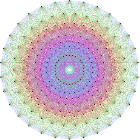

I am taking a risk here, but hoping it will not ignite wrath in the reader. In trying to get an intuition of Lie theory this diagram is all but impossible to ignore:
Unfortunately, there are many youtube videos on the group E8 and its applications to subatomic particles and such. Yet, the actual diagram is not clearly addressed.
So, knowing fully well that the math behind it is at this point beyond my level, I would like to ask for:
  1. What is the specific name of this diagram? Is it a Dynkin diagram? Does it have any other names?
  2. What is the name and/or layperson's idea of what the color coding, nodes and edges represent?

The diagram you posted is not a Dynkin diagram, but is the projection of the convex hull of the root system $E_8$ in the Coxeter plane, i.e. the invariant plane for the action of the Coxeter element on the Euclidean space where you embed the Root System of type $E_8$.
Moreover, the different colors of the edges in the picture correspond to the ordering relations between the roots, w.r.t. the ordering induced by the choice of a set of simple roots.

The explanation by John Stembridge (credit to Sabino Di Trani for linking there) is a great starting (and perhaps even end) point. I quote the beginning:
The Lie group E8 has a "root system" associated to it that consists of 240 points in 8-dimensional space. Similarly, the Lie group E7 has a root system of 126 points in 7-dimensional space.
These 240 points are tightly packed together in a highly symmetric way. In fact, this configuration has a total of 696,729,600 symmetries. Contrast this with what happens if you take the 8 points at the corners of a 3-dimensional cube. These 8 points have "only" 48 rotational and reflective symmetries.
Of course we can't really visualize any objects in 8 dimensions, but we can draw 2-dimensional projections of them. For example, if you imagine shining a flashlight on a cube, the shadow it casts would (depending on how you orient the cube) look like a hexagon. And if you orient the cube just right, the shadow it casts would look like a regular hexagon--a six sided figure with all sides of equal length and all angles of equal measure. Taking it one step further, if you imagine the cube as a wire frame -- 8 points together with links that connect along edges of the cube, then the projection would look like 6 dots at the corners of a hexagon, plus another dot in the center, plus lines connecting nearby dots.
What I've done with the root system of E8 is completely analogous. I picked the "just right" direction to shine a light on these 240 points so that the 2-dimensional shadow they cast is as symmetric as possible.

EDITED IN LATER: let me try and answer the concrete questions from the original post.
One take-away from my last paragraph above is that lattices and hence root systems are really rigid objects. It is old school geometry: distances, angles, location in space all still have their standard meaning here. Nothing is abstracted away into topology or linear algebra or defined over an abstract field, it is just the good old way of thinking about geometry you had in primary school, except of course for the fact that you don't restrict yourself to only 3 dimensions. As a result of this it makes perfect sense to pick an arbitrary (or not so arbitrary) two-dimensional plane in the space where the lattice and root system live and consider the orthogonal projection of the root system onto that plane.
That is what this is.
So to answer the first question:
What do the vertices represent?
The vertices are the actual locations of the projections ('shadows') of the elements of the root system (which themselves are by their nature points in space) onto a cleverly chosen plane.
The 'cleverly chosen' part is important here. You can imagine that if you would have picked a random 2D-plane to project on, the configuration of vertices would be a lot less symmetric. This brings us to the second question:
Does this diagram have a name?
As far as I know: no. But the plane onto which the root system is projected, which yields the incredibly nice rotational symmetry, does. It is the Coxeter plane. So one name for the diagram is The projection of the root system [of $E_8$] onto the Coxeter plane. I put the 'of $E_8$' into block brackets because you could make similar pictures for $A_2$, $D_4$ etc.
Now:
What do the edges represent?
Edges connect each vertex to the vertices that in the actual root system are its nearest neighbors. The fact that some of the edges run between vertices that are no longer nearest neighbors in the projection suggests that the original root system was projected down from a space with more than 2 dimensions. In fact it came from a space with 8 dimensions. We sort of already knew that, of course; the subscript 8 in $E_8$ was a bit of give-away.
Finally:
What does the color code represent?
As far as I can tell from the link in the other answer: not much. One thing that is so nice and special about the Coxeter plane is that the roots (that is what elements of a root system are called) are projected into a relatively small number of rings (instead of all over the place). The colors reflect that. Colors are assigned one color to each ring and then each edge is colored in the color of the outermost ring it has a vertex in. As far as I can tell this functions mostly for making the picture more transparent. In as far as the colors have a deeper meaning which could be described in the original 8-dimensional setting without bringing in the Coxeter plane, they thus represent a property of the vertices rather than of the edges.

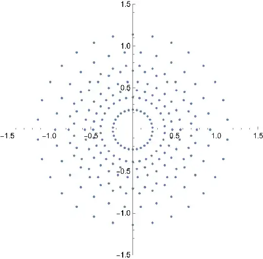

Inspired by the great answers this question generated I wanted to try my hand showing 2D-projections of the root system $E_8$. The animations below are linear combinations of two projections to two planes rotated by the Coxeter element of my choice. The weights in the linear combination follow the obvious $(\cos t,\sin t)$ parametrization, and in the animations $t$ is given two degree increments, so the animation repeats after 90 frames (the symmetries mean that an increment of 180 degrees leaves the picture invariant). At $t=0$ both animations reproduce the set of the projections of the $240$ roots on the eight concentric circles. As shown in the OP.
In other words, by tracking the motion of individual points I try to give some kind of 4-dimensional projections of the root system. Not sure this is the best way to go about it, and I'm open to suggestion as to what to include. I think of this as a mini-project I want to share. Others are surely more competent/experienced at visualizing high-dimensional configurations!
