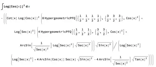

In my favorite CAS is has two identic forms integrate in the sense of an unbounded general integral. I can only do screenshots because the MathML is ill-posed. This can be looked up in books with integreal relationsships and representations like Abramovitch, Stegun.
First a longer one:
integral
Now are either integration done automatically or looked up in formula collections.
Evaluating this at the limits of the given integral is:
doubly singular. The signs do not change for -/+ . So the limits have to be taken. These are not too easy and need complex theory and residue methodology.

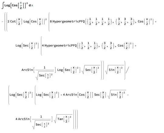

The problem gets simpler with the substitution t=x/2 and the knowledge that the function is even.

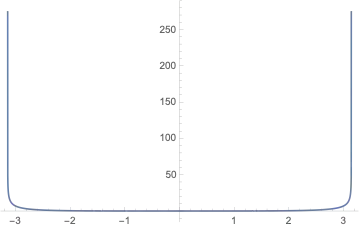

This is the graph of the function of the question:

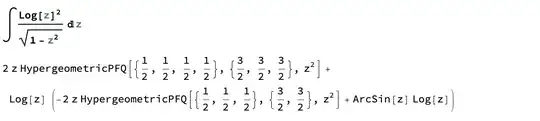

With the substitution z=Cos[t] from @z-ahmed we get something even easier:
even easier representation
The process path can be gone in this direction and reverse. Mind the minus sign.
