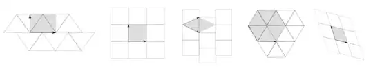

There's a difference depending on what structure about the lattice you want to consider. As groups, every lattice you mentioned is the same. They're all free Abelian groups generated by two elements, so they're isomorphic to $\mathbb Z^2$. Thus, all the corresponding quotient spaces are the same $\mathbb R^2 /\mathbb Z^2$.
If you are interested in the geometrical structures of the lattices, then you should look at their symmetry groups. In this sense, there are five different kinds of lattices in $\mathbb R^2$:
The five lattices in R2.

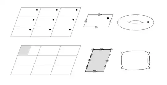

Their symmetry groups are some of the Wallpaper Groups. These groups have the form $G = \mathbb Z^2 \times D$, where $D$ is a discrete group generated by rotations and reflections.
Then you consider the symmetry group $G$ acting on $\mathbb R^2$. When $D$ is the trivial group, you'll get that $$\mathbb R^2 / G = \mathbb R^2/ \mathbb Z^2 \times D \cong \mathbb R^2/\mathbb Z^2.$$ So you are in the case you mentioned at the very beginning of your question. In general the quotient space $$\mathbb R^2 / G \cong \mathbb T^2/D$$ will be an Orbifold, $i.e.$ a geometric space which is a manifold except for a finite set of points (take a look at the section "orbifold notation" in the previous link). You can perform the intuitive identifications on the fundamental region of your pattern. Moreover, these orbifolds characterize the available symmetries for wallpapers.
Examples of patterns and their associated orbifolds.
All this is very nicely explained in the book "The symmetries of things" by J. Conway, C. Goodman-Strauss and H. Burgiel.
