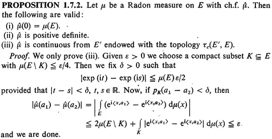

A "proof" of this claim can be (found in Linde's Probability in Banach Spaces), but I have no idea why this proof is correct, since he is concluding the continuity immediately from $(2)$ (for a single $K$):
Maybe we need to assume that $\mu$ is even Radon, i.e. that for all $B\in\mathcal (E)$, there is a compact $C\subseteq E$ with $C\subseteq B$ and $|\mu|(B\setminus C)<\varepsilon$. The author is actually imposing this assumption, but he obviously doesn't make use of it in his proof (he would need to consider an arbitrary compact $\tilde K\subseteq E$, as I did above).

Hopefully, I didn't make any stupid mistake, but I think I figured out why the argument in the excerpt is correct.

Theorem 1: If $\mathcal F\subseteq\mathcal M(E)$ be $\left\|\;\cdot\;\right\|$-bounded and tight, then $\{\hat\mu:\mu\in\mathcal F\}$ is uniformly $\sigma_c(E',C)$-equicontinuous.
ProofI: Let $\varepsilon>0$. Since $\mathcal F$ is $\left\|\;\cdot\;\right\|$-bounded, $$c:=\sup_{\mu\in\mathcal F}\left\|\mu\right\|<\infty.$$ And since $\mathcal F$ is tight, there is a compact $K\subseteq E$ with $$\sup_{\mu\in\mathcal F}|\mu|(K^c)<\frac\varepsilon3.\tag5$$ Assume $c\ne0$. Then $$\delta:=\frac\varepsilon{3c}$$ is well-defined. Let $$N:=\{\varphi\in E':p_K(\varphi)<\delta\}.$$ Now, $$\int_K\underbrace{\left|e^{{\rm i}\varphi_1}-e^{{\rm i}\varphi_2}\right|}_{\le\:|\varphi-1-\varphi_2|}{\rm d}|\mu|\le\left\|\mu\right\|p_K(\varphi_1-\varphi_2)<\frac\varepsilon3\tag6$$ and hence \begin{equation}\begin{split}|\hat\mu(\varphi_1)-\hat\mu(\varphi_2)|&\le\int\left|e^{{\rm i}\varphi_1}-e^{{\rm i}\varphi_2}\right|{\rm d}|\mu|\\&=\underbrace{\int_K\left|e^{{\rm i}\varphi_1}-e^{{\rm i}\varphi_2}\right|{\rm d}|\mu|}_{<\:\frac13\varepsilon}+\underbrace{\int_{K^c}\underbrace{\left|e^{{\rm i}\varphi_1}-e^{{\rm i}\varphi_2}\right|}_{\le\:2}{\rm d}|\mu|}_{<\:\frac23\varepsilon}<\varepsilon\end{split}\tag7\end{equation} for all $\mu\in\mathcal F$ and $\varphi_1,\varphi_2\in E'$ with $p_K(\varphi_1-\varphi_2)<\delta$; i.e. $$\forall\mu\in\mathcal F:\forall\varphi_1,\varphi_2\in E':\varphi_1-\varphi_2\in N\Rightarrow\hat\mu(\varphi_1)-\hat\mu(\varphi_2)\in B_\varepsilon(0)\tag8.$$
By definition of $\sigma_c(E',E)$, the seminorm $p_K$ is $\sigma_c(E',E)$-continuous. Thus, by Lemma 1, $$N=\delta U_{p_K}\in\mathcal N_{\sigma_c(E',\:E)}(0)\tag9$$ and hence we should have shown the claim.
