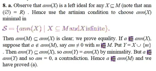

If $R$ is left Artinian, $X$ a subset of a left $R$-module $M$, define $\operatorname{ann}(X) = \{a \in R: ax = 0, \forall x\in X \}.$
(a) Show $\operatorname{ann}(M) = \operatorname{ann}(X)$ for some finite subset $X \subset M$
(b) If $\operatorname{ann}(M) = 0$ show $R$ is isomorphic to a submodule of $M$.
So let me tell you what I thought first.
(a) I think that anything that annhilates $m \in M$, certain annhilates $x \in X$. But since there may be more elements annihilating $M$ (because $M$ is the larger set containing $X$), we should get $\operatorname{ann}(X) \subset \operatorname{ann}(M).$ For the other inclusion, we need to construct a left descending series to use the Artinian property.
(b) I am almost certain that this is just done by the multiplication map $R \to M$ given by $r \to rm$, then $R/\ker = R/\operatorname{ann} M = R/0 = M$
The above is the answer to part (a), but I just don't quite understand it.

    I've answered part $(b)$ by constructing a counterexample. For part $(a)$, the solution you asked about looks clear to me, so if you could edit your posted question to identify more specifically what points you don't understand, I'll edit my answer to address those points. – quasi Nov 14 '20 at 02:40
