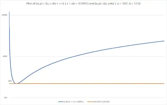

Update (Oct 21, 2020):

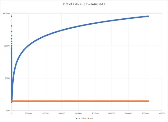

There is an interesting empirical observation from the plot of $\lfloor {z \over r} \rfloor + r$ and its relationship to the sum $a+b, z = ab$ with $a,b$ positive. Plot shown below for $z=12091, a+b=220$.
Plot of z div r + r and its relationship to the sum a+b, z = ab

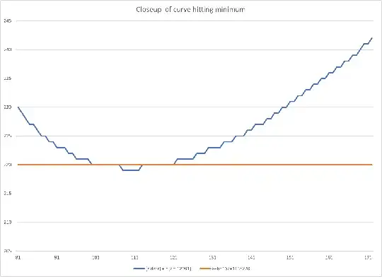

Here is a closeup of the range where the curve hits minimum.
Closeup of range where curve hits minimum
This means, if we pick a reasonably good estimate for $\lfloor {z \over r} \rfloor + r$ with $r = r_e$ being the corresponding value of $r$ and also pick random $r_0$ and $r_1$ such that $r_0 < r_e < r_1$, we can then determine the minimum $\lfloor {z \over r} \rfloor + r$ using successive bisection of the range $[r_0, r_1]$ since the minimum value of $\lfloor {z \over r} \rfloor + r$ must lie in either $r \in [r_0, r_{mid}]$ or $r \in [r_{mid}, r_1]$ where $r_{mid} = {r_0 + r_1 \over 2}$.

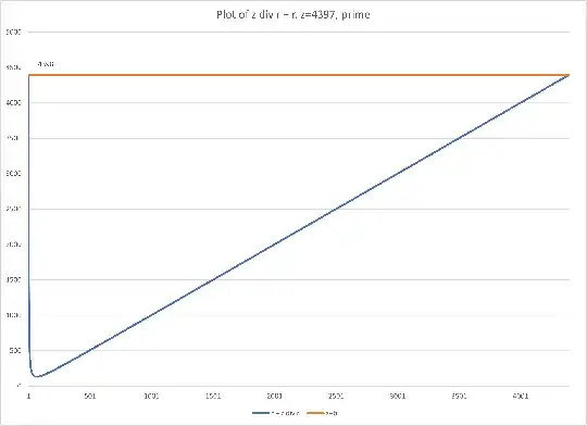

For $z$ prime, we get a plot as given below (example for $z = 4397$, prime):
Plot for prime
As we can observe, for prime $z$, the distance between the sum of divisors (i.e, $a+b = 1+z$ is maximal from the minimum of $\lfloor {z \over r} \rfloor + r$.

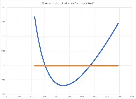

For $z = 3 \times \ 443 \times 617 = 819993$, the plot of $\lfloor {z \over r} \rfloor + r$ is given below:
Plot of z div r + r for z = 819993
Here's the closeup of the plot of $\lfloor {z \over r} \rfloor + r$ for $z = 3 \times \ 443 \times 617 = 819993$
Closeup of the plot for z = 819993

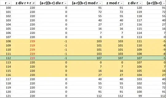

Here is some empirical data for this conjecture:
This table is for $z=12091=103\times117$. The minimum of $\lfloor {z \over r} \rfloor + r$ is $219$. The values of $r$ that give this minimum value for $\lfloor {z \over r} \rfloor + r)$ are $r \in [108,112]$. For $r = 112$, we have $z \mod r = 107$ and $GCD(107, 12091) = 107$, a non-trivial divisor of $z$.
Table for z=12091=103x117

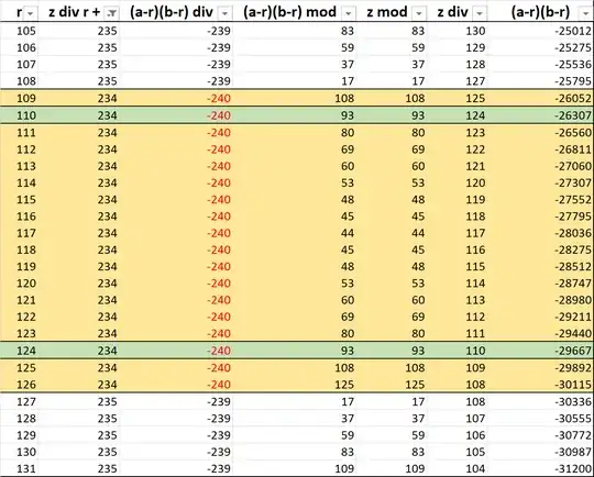

This table is for $z=13733=31\times443$. The minimum of $\lfloor {z \over r} \rfloor + r$ is $234$. The values of $r$ that give this minimum value for $\lfloor {z \over r} \rfloor + r)$ are $r \in [109,126]$. For $r \in \{110,124\}$, we have $z \mod r = 93$ and $GCD(93, 13733) = 31$, a non-trivial divisor of $z$.
Table for z=13733=31x443
[End of Conjecture C3 (proven false)]
