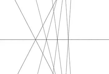

Consider an arrangement of $n$ lines that splits the plane into $\frac{n(n+1)}{2} + 1$ regions, such that, for simplicity, lines are paired into groups of two, where each line in the $k$th pair has a root at $k$ and the negative slope of its partner.
If $n$ is odd, there will be one line left over which can't be paired; put this line horizontally underneath the roots of the pairs (e.g. $y = -1$). If $n$ is even, take the last pair and put one line horizontally as described, and the other vertically at $x = 0$.
an example arrangement

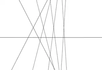

We can hand-wave to "pull down" pairs one-by-one so their intersection rests on the horizontal line, subtracting one region for each pair "pulled down." This ends up removing $\frac{n-1}{2}$ regions for odd $n$, and $\frac{n}{2} - 1$ regions for even $n$.
animation of 'pulling down'

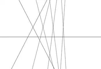

Then we can go through each pair of lines and adjust the line with negative slope to have the same slope as the next pair's positively sloped line, shaving one region off each time (and removing the same number of regions as the previous operation).
animation of adjusting slopes
