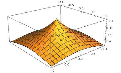

No. Consider the function $f(x,y) = e^{-\sqrt{x^2+y^2}}$. Then $f$ is continuous everywhere, but $f(0,0)$ has no directional derivative at $(0,0)$. I'll let you prove this rigorously on your own, but this should be clear from the plot below; the graph is obviously not differentiable at the "tip". enter image description here
Phil
  • 1,098
  • Approaching the origin from any angle, the slope has a limit. What is that value if not a directional derivative? – Tavin Jul 16 '23 at 21:20
