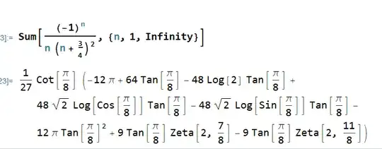

The first sum, $S_1$, is the most bothersome. Not only does it not have any reasonable closed form representations, but it converges quite slowly. So, I'm going to use an Euler Transform to accelerate the convergence of the series. For an alternating series we can use the transform $$\sum_{n=0}^\infty (-1)^n a_n=\sum_{n=0}^\infty (-1)^n\frac{\Delta^n a_0}{2^{n+1}}$$ Using the forward difference operator: $$\Delta^n a_0=\sum_{k=0}^n(-1)^k~{}_{n}\mathrm{C}_k ~a_{n-k}$$ First, an index shift: $$S_1=\sum_{n=1}^\infty\frac{(-1)^n\ln\left(n+\frac{3}{4}\right)}{n}=-\sum_{n=0}^\infty\frac{(-1)^n\ln\left(n+\frac{7}{4}\right)}{n+1}$$ Let $a_n=\ln(n+7/4)/(n+1).$ Euler's transform tells us that $$S_1=-\lim_{N\to\infty}\sum_{n=0}^N\left[\frac{(-1)^n}{2^{n+1}}\left(\sum_{k=0}^n(-1)^k~{}_n\mathrm{C}_k\frac{\ln\left(n-k+\frac{7}{4}\right)}{n-k+1}\right)\right]$$ Which converges to 5 decimal precision with only $N=11$. With $N=35$ it converges to 12 decimal precision. See my implementation on Desmos. So approximately speaking $$S_1\approx −0.288525102601$$ Now for the third sum. According to Mathematica, it does actually have a "closed form", but it's pretty horrific. I can't be bothered to typeset it all, so I'll just post a screenshot. mathematica output
It makes use of the Hurwitz zeta function. Anyway, the numerical value is $$S_3\approx -0.276850451954$$ So, finally, $$\mathcal{S}\approx \frac{−0.288525102601}{4}+\frac{0.276850451954}{48}-\frac{1}{2}\left(\frac{4}{9}-\frac{\pi}{3\sqrt{2}}-\frac{\ln(2)}{3}+\frac{\sqrt{2}\ln(1+\sqrt{2})}{3}\right)-\frac{\ln(2)}{4}\left(\gamma+\ln(8)-\frac{\pi}{2}\right)\approx -0.198728103723$$ You might ask yourself: why did we do all this work? The answer: speed of convergence. If we look at the partial sums of the original: $$\mathcal{S}_N=\sum_{n=1}^N\left[\frac{(-1)^n}{n}\sum_{k=1}^n\frac{1}{4k-1}\right]$$ It converges very poorly. See my implementation on Desmos. Even at $N=40$, with respect to the approximate sum that I found, the partial sums of the above jump around with a relative error of $\mathbf{15\%}$ (!) So yes, our work wasn't all pointless :)
