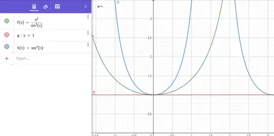

Try the following sandwich relation $$1<\frac{x^{2}}{\sin^{2}x}<\sec^{2}x$$
This easily gives you your desired limit.
Also, this relation can be graphically represented as follows
That's the sandwich :P
