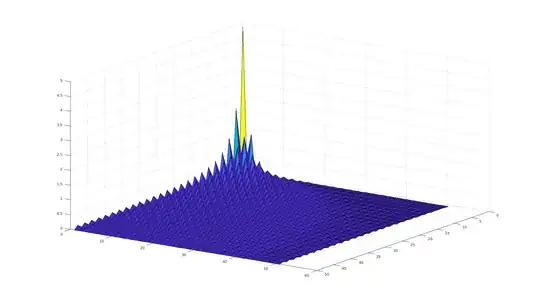

However, numerical experiments suggest that for any $p_0, q_0 \in \mathbb{N}$, $$\lim\limits_{q\to\infty} I_{p_0,q} = 0 \qquad \lim\limits_{p\to\infty} I_{p,q_0} = 0$$ The plot below shows a numerical approximation (computed with MATLAB's integrate2) to $I_{p,q}$ as a function of $p$ and $q$.
<span class=$I_{p,q}$ as a function of $p$ and $q$" />
