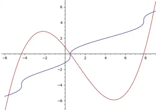

Fig. 1 : On the same figure, a plot of functions $p$ (in fact $\frac{1}{20}p$) and $q$. Please note the inflection points of $q$ whose abscissas are the roots $\approx -4.3194676,\ \ 0.50354521,\ \ 7.8159224$ of $f$.
SAGE program for the generation of the figure (its interest is to show how the cubic root function $r3$ has to be re-defined)
var('x')
def r3(x) :
  if x > 0:
  y = (x)^(1/3)
else:
  y = -(-x)^(1/3)
return y
#s=solve(x^3 - 4*x^2 - 32*x + 17==0,x)
def g(x) :
  z = r3(x-0.50354521)+r3(x+4.3194676)+r3(x-7.8159224)
return z
G1=plot(0.05*(x^3 - 4*x^2 - 32*x + 17),-6,9,color='red');
G2=plot(g,-6,9);
G1+G2
