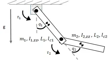

Mechanical system
\begin{equation}\label{eq:sis2} \mathbf{M}(\mathbf{q})\ddot{\mathbf{q}}+\mathbf{C}(\mathbf{q},\dot{\mathbf{q}})\dot{\mathbf{q}}+\mathbf{g}(\mathbf{q})=\boldsymbol{\tau} \end{equation}
$\mathbf{q}(t)\in \mathbb{R}^{2\times 1}$, $\mathbf{M}(\mathbf{q})\in \mathbb{R}^{2\times 2}$, $\mathbf{C}(\mathbf{q}, \dot{\mathbf{q}})\in \mathbb{R}^{2\times 2}$, $\mathbf{g}(\mathbf{\dot{q}})\in \mathbb{R}^{2\times 1}$, $\boldsymbol{\tau} \in \mathbb{R}^{2\times 1}$.
Inertia Matrix: $\begin{equation*} \mathbf{M}(\mathbf{q})=\begin{bmatrix} m_{11}&m_{12}\\ m_{21}&m_{22}\\ \end{bmatrix} \end{equation*}$, Coriolis:$\begin{equation*} \mathbf{C}(\mathbf{q},\dot{\mathbf{q}})=\begin{bmatrix} -2\phi\dot{q}_{2}&-\phi\dot{q}_{2}\\ \phi\dot{q}_{1}&0\\ \end{bmatrix} \end{equation*} $, gravity vector: $\begin{equation*} \mathbf{g}(\mathbf{q})=\begin{bmatrix} (h_{1}+h_{2})g&h_{2}g \end{bmatrix}^{T} \end{equation*}$.
\begin{align*} &m_{11}=m_{2}L_{1}^2+m_{2}l^2_{c2}+m_{1}l^2_{c1}+I_{1}+I_{2}+2m_{2}L_{1}l_{c2}\cos (q_{2})\\ &m_{12}=m_{21}=m_{2}l_{c2}^2+m_{2}L_{1}l_{c2}\cos (q_{2})+I_{2}\\ &m_{22}=m_{2}l_{c2}^2+I_{2}\\ &\phi=m_{2}L_{1}l_{c2}\sin q_{2}\\ &h_{1}=(m_{1}l_{c1}+m_{2}L_{1})\sin q_{1}\\ &h_{2}=m_{2}l_{c2}\sin (q_{1}+q_{2})\\ \end{align*}

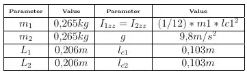

Physical values:

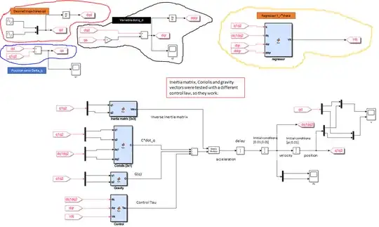

Simulation scheme:

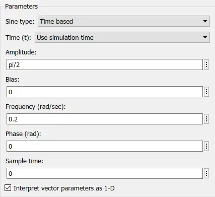

Desired trajectories:
Control block:\

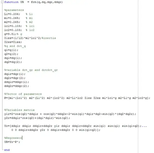

Regressor block:\

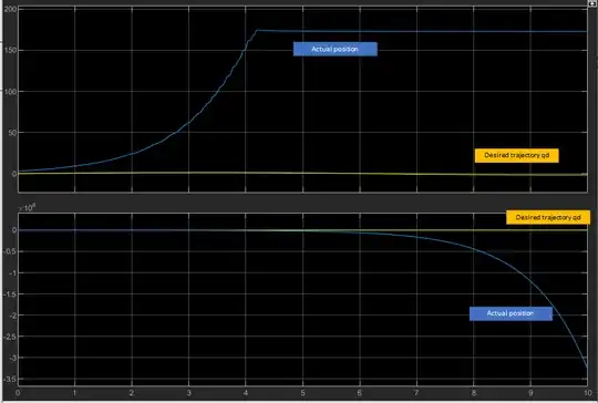

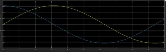

Position Response:

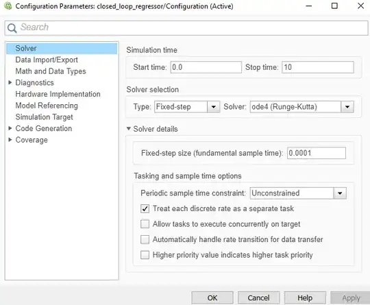

I'm using a fixed integretion step time and runge-kuta4 solver as shown in the image below:
As you can see the response there is no convergence in the response in opposition to the theory which says it should. To be honest I don't know what I'm doing wrong thats why I need your help guys if possible. Here is the link to the simulation file again Simulation file (the extension is mdl, should work with any version of matlab). Thanks in advance fopr any help.
I solved it. Theory is correct, the problem was $\dot{\mathbf{q}}_{r}$ in simulink, I was being redundant with the variables, so instead of using the derivatives that were already in simulation I was adding more derivative blocks and probably causing issues in simulation. Plus to make sure I had no errors in the regressor, I basically have rewritten it as:
\begin{equation} \mathbf{Y}_r=\mathbf{M}(\mathbf{q})\ddot{\mathbf{q}}_{r}+\mathbf{C}(\dot{\mathbf{q}},\mathbf{q})\dot{\mathbf{q}}_{r}+\mathbf{G}(\mathbf{q}) \end{equation}
inside the function block in simulink. Here is the link to download the mdl file: corrected simulation
