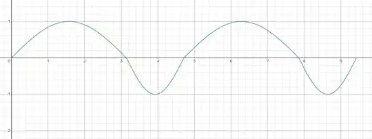

The simplest way to do this is to take two sine waves, say $f$ and $g$, with $g$ having half the period of $f$, and piece them together accordingly:
Let the parameter $t$ be thought of as time, and $f(t)$ the brightness at time $t$. We will admit brightness between $-1$ and $1$, which can be converted as desired (e.g. height $-1 = 50$ lumens, and height $1 = 50,000$ lumens).
Let $f(t) = \sin(t)$, and $g(t) = -\sin(2t)$. Define a new function: $$ F(t) = \begin{cases} f(t), & t \in [0,\pi], \\ g(t), & t\in [\pi,\frac{3\pi}{2}]. \end{cases} $$ Notice that $f(\pi) = g(\pi) = 0$, so $F$ is continuous (as we might hope a brightness function in a video game to be). Moreover, $F$ can be copied side by side indefinitely, to form a new function which will be $\frac{3\pi}{2}$ periodic. To be technical, the function you really want is (where $n \in \mathbb{N}$): $$ G(t) = \begin{cases} f(t-\frac{3\pi n}{2}), & t \in [\frac{3\pi n}{2},\frac{3\pi n}{2} + \pi], \\ g(t-\frac{3\pi n}{2}), & t\in [\frac{3\pi n}{2} + \pi, \frac{3\pi n}{2} + \frac{3\pi}{2}]. \end{cases} $$ Below is an example of how it would look iterated over $2$ cycles:
ccroth
  • 916
  • I'm pretty sure the minimum of the desired graph is $0$, not $-1$. – Aiden Chow Sep 03 '20 at 04:00
  • I tried this thing just now, where F is used when Y > .5 and G is used when Y <= .5. Didn't work. Is that not right? My question is, when do I make the switch – Eyesight Technology Sep 03 '20 at 04:09
  • @AidenChow Yes I saw the desired min. was $0$ not $-1$ but it's trivial to just add $1$ to the entire function, and then scale down by $1/2$. I left those things out for the sake of simplicity and because it's not the focus of the problem, imo. – ccroth Sep 03 '20 at 23:57
  • @EyesightTechnology I graphed it in Desmos exactly how I wrote it here, and it produces the above graph. Look carefully at the intervals for each piece of the function, and note the arguments of the component functions (for $G$) are $t - 3\pi n/2$ rather than just $t$. – ccroth Sep 04 '20 at 00:01
