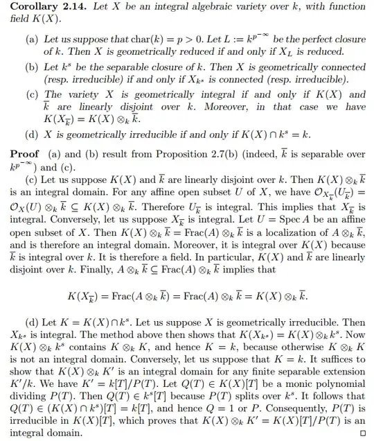

I'm reading Qing Liu's book corollary 3.21.
The condition of this corollay is 'X is a reduced connected algebraic variety proper over a field $k$'. Then the author conclude that $K\otimes_k\bar k = \mathcal O(X_{\bar k})$ where $K = \mathcal O_X(X)$ from a proposoition 2.24.
But this book does not have proposition 2.24.... The only theorem might be relevent is propositon 2.14 which shows a similar result but just for geometrically integral variety.
I'm confused how to get this identity.
I'm also wondering, in general, under what condition can we deduce that $\mathcal O_X(X)\otimes_k\bar k = \mathcal O(X_{\bar k})$?

  • Thank you for your answer! In fact, Qing Liu refers to proposition 2.24 which does not exist in his book. This makes me confused. So I think it might be a typo and maybe he want to refer to proposition 2.14. – Hydrogen Aug 28 '20 at 22:16
  • @Hydrogen The only proposition 2.14 in the entire book refers to divisors (page 270 in my copy). Corollary 2.14 in the previous section does not do what you want, either. I agree that it is an error, but from the reading I did, there's no result already in the text that you can just replace it with. – KReiser Aug 28 '20 at 22:51
