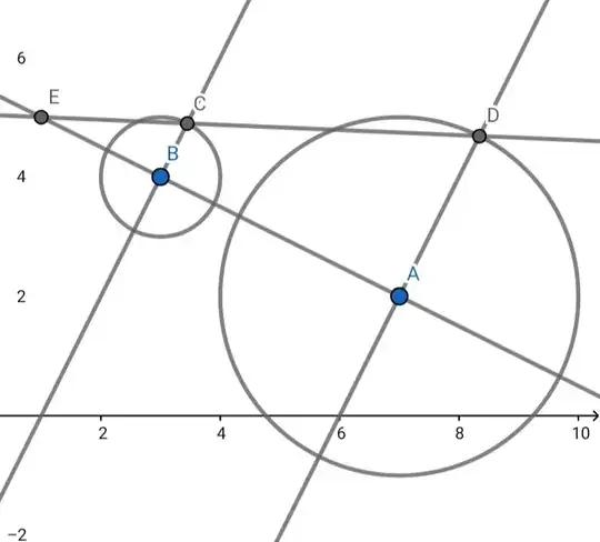

You need any two pairs of non-colinear homologous points two determine the dilation point. Here, I've taken one pair as $(C, D)$ and the other is points lying on the line joining centres of both the circles. Intersection of the two lines is the dilation point. Also, see this.
Another way to find the center of dilation is to consider the intersection point of direct common tangents since the point of contacts of both the circles are homologous, too. See @Andrei's comment for transverse common tangent. Image for reference.
SarGe
  • 3,061
  • I think the drawing is the best way to understand it. I assume you chose $C$ and $D$ so that $CB\perp AB$ and $DA\perp AB$. It is not necessary, but it's the obvious choice. +1 – Andrei Aug 26 '20 at 18:29
  • Also note that we can choose a point in between $A$ and $B$, so that the point $C$ would be mapped into the point diametrically opposed to $D$ – Andrei Aug 26 '20 at 18:31
  • Thank you for the explanation! – raynea Aug 26 '20 at 18:43
  • @Andrei is right : there is a second center of homothety called internal homothetic center situated at about $(4,3.2)$ which is the intersection of internal common tangents (instead of external ones) : see the figure in https://en.wikipedia.org/wiki/Homothetic_center – Jean Marie Aug 26 '20 at 22:31

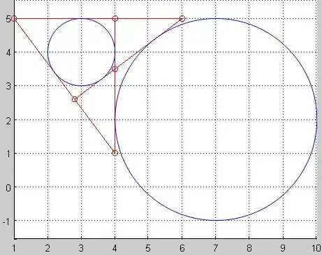

Here is a solution based on the computation of pairs of (common) tangents. This is done by using a powerful formula (ill) known as $(SS_1-T^2)=0$. Knowing this very general formula can be useful for treating potentially more complicated issues of a similar type, even if in this case it could be considered as "overkill". A drawback of this formula (but is it really one ?) is that it necessitates the use of a CAS (Computer Algebra System).
Let us first recall that the tangent in $(x_0,y_0)$ to a conic curve with equation
$$S(X):=ax^2+by^2+2cxy+2dx+2ey+f=0 \ \text{where} \ X=(x,y)\tag{1}$$
is
$$T(X,X_0):=axx_0+byy_0+c(xy_0+x_0y)+d(x+x_0)+e(y+y_0)+f=0\tag{2}$$
Now, the main formula, currently taught in the early 20th century, but largely unknown in 2020:
Theorem (formula $SS_1-T^2=0$): the cone issued from $(x_1,y_1)$ and tangent to a conic curve with equation (1) is given by formula:
$$S(X)S(X_1)-T(X,X_1)^2=0\tag{3}$$
Of course, in 2D, replace "cone" by "pair of tangent line equations". But it is important to know that this formula is generalizable to 3D and even nD.
A 3D example can be found here.
In our case, we are going to do the inverse path: we will be looking for points $X_0=(x_0,y_0)$ such that equation (3) is fullfilled for our 2 circles with equations, $S_1=0$ and $S_2=0$.
As we have $4$ common tangents, we must await $6=\binom{4}{2}$ pairs of tangents and in particular $6$ intersection points of these pairs of tangents that are depicted (red dots) in the figure, among which we will find the two dilation centers, the positive one and the negative one
$$(1,5) \ \text{and} \ (4,7/2)$$
More precisely, but without entering into the details, it suffices to compare the coefficients of $x^2$, $xy$ and $y^2$ in the expansions of $$S_1(X)S_1(X_0)-T_1(X,X_0)^2=0 \ \text{and} \ S_2(X)S_2(X_0)-T_2(X,X_0)^2=0$$ to get the following system :
$$\begin{cases}(y_0^2 - 8y_0 + 15)&=&a(y_0^2 - 4y_0 - 5)\\ (8x_0 + 6y_0 - 2x_0y_0 - 24)&=&a(4x_0 + 14y_0 - 2x_0y_0 - 28)\\ (x_0^2 - 6x_0 + 8)&=&a(x_0^2 - 14x_0 + 40)\end{cases}\tag{4}$$
($a$ being a proportionnality coefficient ; all this is to be done of course by a CAS).
(4) is a system of 3 equations with three unknowns. Its solutions are the 6 points:
$$(x_0,y_0)=(6,5),(4,1),(1,5),(4,5),(4,7/2), (14/5,13/5)$$
that we can see on the figure.
