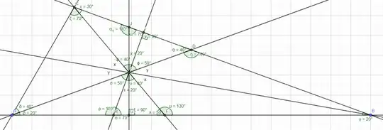

Problem statement:
In a triangle $ABC$ with angles $\angle BAC = 60^\circ$ and $\angle ABC = 20^\circ$, a point $E$ inside the triangle is given such that $\angle EAB = 20^\circ$ and $\angle ECB = 30^\circ$. Prove that $E$ lies on an angle bisector of $\angle ABC$.
I drew a picture in Geogebra for this problem and this is what I did so far: enter image description here
All angles drawn were found out by using the fact that the sum of angles in a triangle is $180^\circ$. I also noticed that $AD=BD$, $AC=CD=AE$ by using isosceles triangles.
I tried proving that $E$ lies on an angle bisector of $\angle ABC$ by proving that $GE=EI$ and so I drew perpendicular bisectors from $E$ to the sides $AB$ and $BC$, and I noticed two pairs of similar triangles: $\triangle AHE \sim \triangle AEF$ and $\triangle CJE \sim \triangle CED$, but I'm not sure if this is useful in any way.
I'm stuck since and I don't know how to continue on from this. I'm not sure if this is even the right approach to the problem. Is there a way of approaching this problem that I missed?

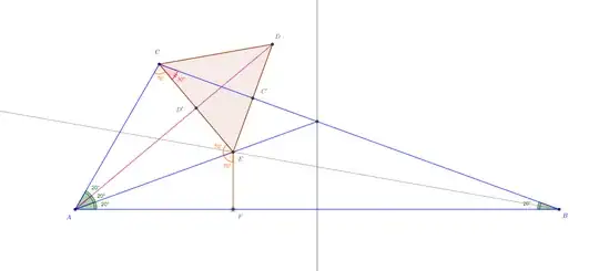

1.st solution: This first solution is in its nature the same ole's solution, it uses but an equilateral triangle to perform the "mule" from one direction to an other one, and comes with a picture.
We construct on $CE$ an equilateral triangle $\Delta CDE$, so that its angle bisector in $C$ is the line $CB$. Let also in this triangle $C'$, $D'$ be the mid points of the sides opposite to $C$, $D$. Let $F$ be the projection of $E$ on $AB$.
Mathematics stackexchange problem 3795377
Then $\Delta CAE$ is isosceles having the angles in $C,E$ of the same measure, $70^\circ$, which implies $\Delta ACD'=\Delta AED'=\Delta AEF$. So $EC'=ED'=EF$.
$\square$

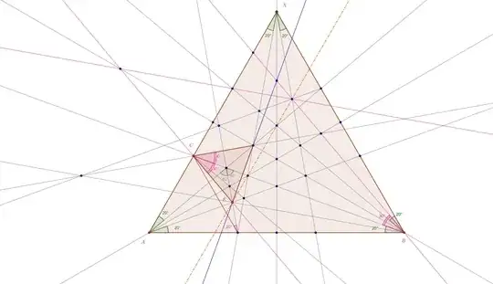

As a digression, it is maybe interesting to see in the context of the "bigger picture" of the equilateral triangle on $AB$ where are the points of the solution, e.g. the point $D$. No comment:
Problem 3795377 mathematics stackexchange

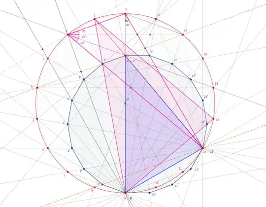

3.rd solution: An other solution which is often self-suggested in such cases is to realize the given triangle as a "part" of a regular polygon, then use the symmetries inside this polygon. This may seem to be an overkill for a solution, producing the most complex picture, but it may be the right structural perspective to understand why there exist such "coincidences", how "many" they are, and how to construct / compose similar problems.
As a comparison, consider Langley's problem, which has many simple solutions, but there is also...
the stackexchange questions 1121534
In our case, the transposition is...
Mathematics stackexchange 3795377 regular polygon

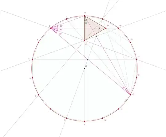

The given triangle configuration is embedded inside a regular polygon as $\Delta (0,2,12)$. We want to show that the diagonals $0-9$; $2-14$, $4-16$, $1-12$, $6-17$ are concurrent in $E$.
We are now performing the following transformation, that brings the regular $18$-gons from the following picture in each other:
Mathematics stackexchange 3795377 transformation
Using as center the point $9$ we use first a rotation that moves $1$ to $0$, then use a similarity which brings the length of the segment $[9,13]$ into the length of the segment $[9,12]$. Of course, we can revert the order of the rotation and homothety without change. To have a quick visual aid of the transformation, two triangles were marked. The red triangle $\Delta(9,13,1)$ is transformed into the blue triangle $\Delta(9',13',1')=\Delta(9,12,1')$. This is so because $9=9'$, $9$ being the center of the rotation and stretching, and the segment $[9,13]$ is mapped to $[9',13']=[9,12]$ since the two segments are in the right angle and the right proportion. Let us identify $1'$ as the point $E$ from the problem.
  • $9,1',0$ are colinear since both lines $90$ and $91'$ build the same angle w.r.t. $90'$.
  • So $9,(k+1)',k$ are collinear for all other values of a vertex $k$.
  • $1,1',12$ are colinear since $\angle (9,12,1)=\angle (9,13,1)=\angle (9',13',1')=\angle (9,12,1')$.
  • In a similar manner, $k,k',12$ are collinear for all other values of a vertex $k$ and transformed vertex $k'$.
  • The lines $1'-2'$ and $4-16$ coincide, this can be shown by using the line through $12=13'$, $O'$, $4'$, $4$ or the parallel line $8-8'-12$ at same distance.

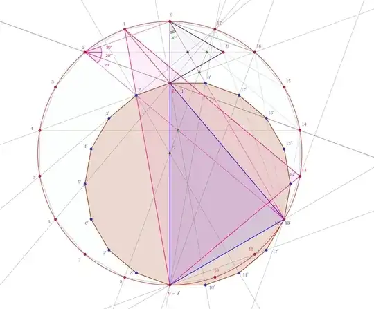

Yet an other picture. mathematics stackexchange 3795377 yet an other pic
