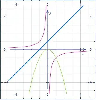

Let $x\ne0$. Then
$$x+1=-x^2\\\iff\\x+1=-\frac1x$$ is true. But
$$x+1=-x^2\land x+1=-\frac1x\color{red}\iff-x^2=-\frac1x$$ is not* ! The logical consequence is only left to right.
As shown on the plot, the curves of $-x^2$ and $-\dfrac1x$ do intersect, but not with $x+1$. By equating the two above RHS, you lose information and introduce non-solutions.

  • +1 The Graph shows that this is an ex falso quodlibet. Both equations don't have a solution, hence they are false, hence anything follows. But ex falso quodlibets are not reversible. – rexkogitans Aug 18 '20 at 07:22
