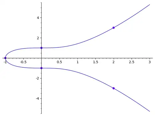

The given integral can be seen as the integral of the invariant differential $dx/y$ on the path $\gamma$ from the point $P=(x_0,y_0)=(0,1)$ to $Q=(x_1,y_1)=(2,3)$ on $E(\Bbb R)$, where $E$ is the elliptic curve given by the (affine) equation: $$ E\ :\ y^2=x^3+1\ . $$ In a picture:
The real view of yy = xxx + 1
Just for the protocol: This was obtained in sage via:
sage: E = EllipticCurve(QQ, [0, 1])
sage: points = [E(P) for P in [ (-1,0), (0,1), (0,-1), (2,3), (2,-3) ]]
sage: pic = E.plot(xmin=-2, xmax=3) sage: for P in points: ....: pic += point(P.xy(), size=40, rgbcolor=hue(0.75)) ....: sage: pic
As the OP remarks, there would be no problem to compute the integral from $P=(0,1)$ to the infinity point using the substitution $t=x^3+1$ to introduce the beta function, but we integrate from $P$ to $Q$, and the same substitution leads to an "incomplete beta" value. So the problem is the upper integration limit $2$ corresponding to $Q$.
We would like to use an algebraic substitution and move $Q$ to a "simpler point" (possibly on some other elliptic curve). Note that the points that appear have finite order, using sage to print this information...
....:     print(f'The point {P.xy()} has order {P.order()}')
The point (-1, 0) has order 2
The point (0, 1) has order 3
The point (0, -1) has order 3
The point (2, 3) has order 6
The point (2, -3) has order 6
The idea to proceed is natural, we use the isogeny which "simplifies" the complicated torsion point $Q=(2,3)$ of order $6$. Note that $2Q=P$ on $E$:
sage: P, Q = E.point((0,1)), E.point((2,3))
sage: 2*Q == P
True
(So using the isogeny which "kills" $P$ will also "simplify" $Q$.)

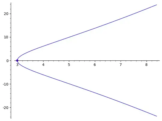

This leads to a map $\phi:(x,y)\to\phi(x,y)=(X,Y)$ between the elliptic curves $$ \begin{aligned} E\ :\qquad && y^2 &= x^3+1\text{ and}\\ E'\ :\qquad && Y^2 &= X^3-27\text{ given by the passage}\\ && X &=\frac{x^3+4}{x^2}\ ,\\ && Y &=y\cdot\frac{x^3-8}{x^3}\ . \end{aligned} $$ and the image curve is $Y^2=X^3-27$, the path $\gamma$ from $P$ to $Q$ on $E(\Bbb R)$ becomes the path $\gamma'$ from $P'=\infty$ to $Q'=(3,0)$ on $E'(\Bbb R)$. I can plot only $Q'$ on $E'(\Bbb R)$...
The real view of YY = XXX-27
So we integrate alternatively the invariant differential form $dX/Y$ on the "upper branch" starting from $Q'=(3,0)$ to the infinity point.
Indeed, the above expressions $X,Y$ satisfy: $$ \begin{aligned} X^3-Y^2 &=\frac{(x^3+4)^3}{x^6}-\underbrace{y^2}_{x^3+1}\cdot\frac{(x^3-8)^2}{x^6}\\ &=\frac 1{x^6} \Big[\ (x^9+12x^6+48x^3+64) - (x^9-15x^6+48x^3+64) \ \Big] \\ &=27\ . \end{aligned} $$
