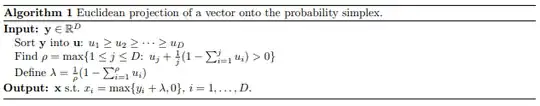

I'm trying to implement the algorithm for Euclidean projection onto the probability simplex in,
https://eng.ucmerced.edu/people/wwang5/papers/SimplexProj.pdf
enter image description here which is widely cited and I presume to be correct.
However, my MATLAB code (which is a direct implementation from the pseudo-code) appears to be wrong and I have no idea how or where this happened after checking for a while.

You're misinterpreting the maximization problem for $\rho$. Specifically, we want the highest possible $j$ for which $u_{j} + \frac{1}{j}(1-\sum_{i=1}^{j}u_{i})$ is still positive. (Instead, you found the $j$ that maximizes it, which always give $\rho=1$ when you're generating positive numbers.)
