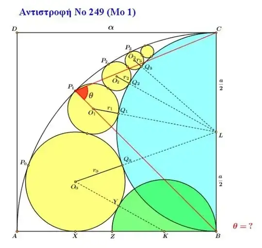

the chain is from the yellow circles.
What I want is a way to draw the next yellow circle given all the ones before it:
I know how to draw the first circle $(P_0Q_0X)$.
I know the (nameless in the picture) contact point of the $n-th$ circle with the $n+1-th$ one lies on a circle centered at $H = P_0Q_0 \cap BC$ passing through $C$.
I know lines $P_nQ_n$ all meet in $H$.
I know quads $P_nP_{n+1}Q_{n+1}Q_n$ are cyclic.
I still can't find a simple way to construct the next circle given the previous one.I know there are one or two inversions that can do the trick but I would prefer if we avoid the temptation of looking for invertions.
I can't prove but I know the circles $P_nQ_nC$ are tangent to $BC$ at $C$
EDIT: also don't just use the general apollonius solution unless you can make sure you can show some symetry from this particular problem. For example: because we know the contact points between two circles lie on a circle centered at $H$ passing through $C$ we don't need the full $CCC$ but we can use $PCC$ (of course you guys are suposed to show more simplifications)

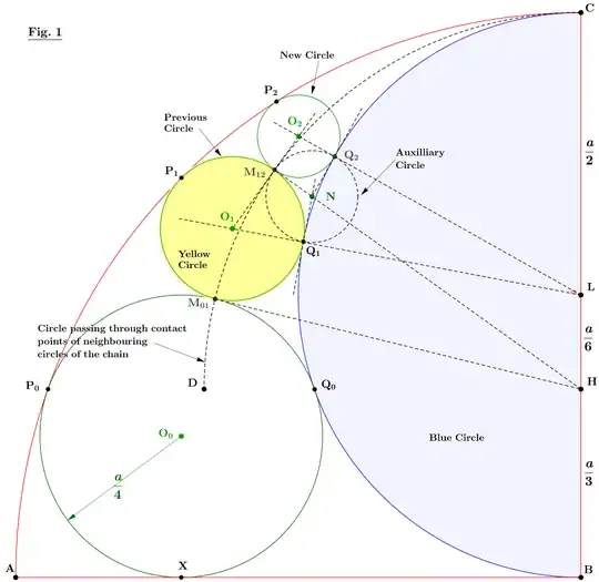

CircleChain We use the point $H$ and the circle that passes through all the contact points of neighboring circles of the chain, which was mentioned by the OP in his post. By the way, $H$ is located on the segment $LB$ a distance of $\frac{a}{6}$ away from the point $L$.
Start the construction by drawing the aforementioned circle, which is marked by the two end-points $C$ and $D$ and has its center located at $H$. Furthermore, its radius is equal to $HM_{01}$. Remember that the point $M_{01}$ is already available at this moment. This circle cuts the circle $O_1$ at $M_{12}$. Draw and extend the line $O_1 M_{12}$. We know that the center of the sought circle of the chain lies on this line.
Now, draw the two lines $M_{12}H$ and $O_1L$. The line $O_1L$ passes through the contact point $Q_1$ of the blue and yellow circles. Then, draw a line perpendicular to the $O_1L$ at $Q_1$ to intersect $M_{12}H$ at $N$. Construct an auxiliary circle with radius $Q_1N$ and having its center at $N$. This circle meets the blue circle at $Q_2$. The line $Q_2N$ is the common tangent of the blue circle and the sought member of the circle chain. Furthermore, $Q_2$ is the contact point of these two circles. Therefore, the center of the sought circle lies on the extended portion of the line $Q_2L$.
Now, we have two lines harboring the center of the sought circle, i.e. $O_1 M_{12}$ and $Q_2L$. Therefore, the point $O_2$, where these two lines meet, is the center of the next member of the circle chain. To complete the construction, draw the circle with radius $O_2Q_2$ or $O_2M_{12}$ taking $O_2$ as its center.
$\underline{\mathrm{Added\space at\space OP’s\space Request\space …}}$
A geometric configuration, in which three circles (e.g. green, yellow and blue circles) touch each other externally, has a unique point (in our case $N$), where the three common tangents coincide. Therefore, we can draw any two of the three common tangents to obtain this point. In other words, the point of intersection of any two common tangents (e.g. $NM_{12}$ and $NQ_1$) gives us this point. That is how we obtained the point $N$ in the first place. Using $Euclid\space Theorem\space 59$, we can show that the three distance from this point to each contact point of a pair of circles are equal. That is why we constructed an auxiliary circle with radius $Q_1N$ (or $NM_{12}$) and having its center at $N$. This circle cuts the blue circle at $Q_2$ giving us the third common tangent $NQ_2$. Now, we know that there exist a unique circle, which touches the yellow circle at $M_{12}$ and the blue circle at $Q_2$ externally. The center of this circle lies at the point of intersection of the two lines $O_1 M_{12}$ and $Q_2L$. The radius of this green circle is chosen as $O_2 Q_2$ to let its circumference pass through the point $Q_2$.
However, the story does not end here, because we have not yet explicitly stated that the green circle we obtained touches the red circle internally. This can be proven using trigonometry. But first, we would like to put forward the following argument. If the green circle cuts or fail to touch the red circle, then, this problem has no solution, because you cannot find another circle that touches the red circle internally and the blue circles externally while touching the yellow circle at $M_{12}$ externally.
If you want us to post the proof, please let us know
YNK
  • 4,620
  • thank you very much, but why is point $Q_2$, as drawn, on the green circle? I do understand that $Q_2L$ is tangent to the auxiliary circle. But how do we know $Q_2$ is on the green one? – hellofriends Aug 07 '20 at 23:57
  • I see it now it is because $HM_{12}$ is radical axis – hellofriends Aug 08 '20 at 00:15
  • @hellofriends I just added two paragraphs to my answer to clear the doubts you expressed in your first comment. If you want to know the proof, please let me know. Thanks for the bonus – YNK Aug 08 '20 at 16:57
