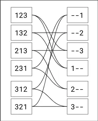

Let $S_n$ denote the set of permutations of length $n$ and let $C_{n,k}$ be the set of covered permutations. For example, the permutation $12345678 \in S_8$ and $123\cdot\cdot\cdot78 \in C_{8,3}$. For brevity I often drop the subscripts.
The act of covering gives us a relation $\sim$ between the two sets, i.e. we say that $\pi \in S$ and $c \in C$ are compatible if $c$ is a covering of $\pi$. We can visualize this compatibility relation as a bipartite graph. For $k=2$ and $n=3$ we have:
$ \qquad \qquad \qquad \qquad \qquad \qquad $
We need to find an injective function $f : S_n \rightarrow C_{n,k}$ such that $\pi$ and $f(\pi)$ are always compatible. The assistant performs the function $f$ and the illusionist performs the inverse $f^{-1}$. As per the problem requirements, both $f$ and $f^{-1}$ need to be computable in poly(n) time for a given input. We note that given such an $f$, computing $f^{-1}$ is straightforward: given a covering $c$, we consider the compatible permutations. Among these, we choose the $\pi$ such that $f(\pi) = c$.
For $n = k! + k - 1$ we note that $|S_n| = |C_{n,k}| = n!\,$. We also note that each permutation is compatible with exactly $k!$ coverings and each covering is compatible with exactly $k!$ permutations. As OP mentioned, the Hall marriage theorem thus implies that a solution exists. We can find such a solution using a maximum matching algorithm on the bipartite graph. This is how @orlp found a solution for $k=3$ in the comments. However, the maximum matching algorithm computes $f$ for every permutation in poly(n!) time, where we instead need to compute $f$ for a single permutation in poly(n) time.
