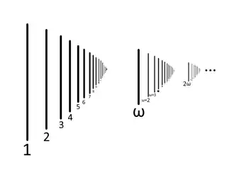

omega
In this diagram each line is labelled with it's corresponding ordinal. Notice how once we've labelled the lines using all the natural numbers $1,2,3\rightarrow\dots$, we can start labeling a second batch of infinite lines starting with $\omega, \omega+1,\omega+2\rightarrow\dots$.
Side note: In this context, that plus sign in $\omega+1$ doesn't exactly mean we're adding 1 to $\omega$, it might be better to say we're simply referring to the ordinal that is directly after $\omega$.

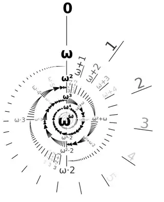

Anyways, after that second batch can start our third batch with $2\omega$ and so on. As you can see, we can proceed to label an infinite amount of infinitely-sized batches. Here is one of my favorite diagrams depicting the same line labeling game spiraling towards $\omega^\omega$
omega spiral
