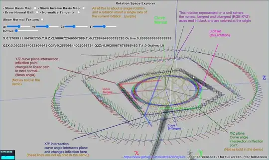

  • For a specific ($X$,$Y$,$Z$) vector there is a curve of related ($X_n$,$Y_n$,$Z_n$) curvatures that share the same normal. This demonstration is just showing the curve of rotation vectors that share the same normal as some specified input (controlled by the X, T, and Z sliders; T is the y rotation... the existing Y slider controls the target rotation; which is the destination point around the curve)
  • The curve is formed by linear interpolation from the intersection points where the unit circle centered at the origin, and the normal of the curve of rotations that share the same normal(up/green) : $((X,Y,Z)/\sqrt(XX+YY+ZZ)) × up(d_T=1/2)$. This substitution results in a double-angle sin/cos substitution, so the /2 of the normal is not used; but IS used anyway because of the 0.5 dT scalar... (represented with *0.5 instead of /2 )
    • $ x = { X \over \sqrt(XX+YY+ZZ) }$, $ y = { X \over \sqrt(XX+YY+ZZ) } $, $ z = { X \over \sqrt(XX+YY+ZZ) } $, $ t = { |X|+|Y|+|Z| } * 0.5 $
    • $ curve_{up_x} = {z * ( 1 - ( 1/2 - \cos(t) ) ( zz - xx - yy ) ) - \sin(t) * yx } $ $ curve_{up_y} = { \sin(t) * ( xx - zz ) } $ $ curve_{up_z} = { x * ( 1 - ( 1/2 - \cos(t) ) ( zz - xx - yy ) ) - \sin(t) * yz }$
    • (untested; algebraic substitution)
  • the tangent(right/red) is : $up(d_T=1/2)$
  • the bi-tangent(forward/blue) is : $normal × tangent$
  • These are the plane crossings where the slope changes from one crossing to the next... There are a maximum of 6 plane crossings and a minimum of 4, if the curve lies exactly in a plane (has a 0 curvature component for that axle). The x y and z plane intersections are... ( $plane_{coordinate}$ )
    $x_x=0$; $x_y =2* -curve_{up_z}/(|curve_{up_y}|+| curve_{up_z}|)$; $x_z =2* curve_{up_y}/(|curve_{up_y}|+ |curve_{up_z}|)$
    $y_x =2* curve_{up_z}/(|curve_{up_z}|+|curve_{up_x}|)$; $y_y=0$; $ y_z = 2* -curve_{up_x}/(|curve_{up_z}|+|curve_{up_x}|)$
    $z_x =2* -curve_{up_y}/(|curve_{up_x}|+| curve_{up_y}|)$; $z_y =2* curve_{up_x}/(|curve_{up_x}|+|curve_{up_y}|)$; $z_z=0$
    • These can also be computed for the square normal - that lies in the circle formation instead of the linear; though I expect updating the unit X,Y and Z components will be easier with a linear adder.

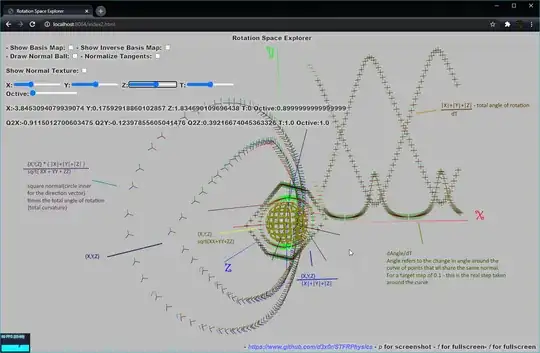

  • (A) For each step around the curve, there is a certain total rotation of that system, this is shown as a graph on the X/Y plane that has a characteristic sin/cos wave to it, and the max+min rotation is always 2π. The scalar of this curve is a component I miss. $ Y = |X|+|Y|+|Z|, X = T $
  • (B) for each step, the angle around the curve changes by a varying amount, this is shown on the X/Y plane, and shows the angle change per step of unit angle around the curve; this $d_{Angle}/d_T$ is one component I miss. This curve is created with the normal of the rotation... $acos(Rotation_t · Rotation_{t-1} )$ as $t$ steps around the curve.
Question - what are the functions that generate (A) and (B); right now all I have is a plot, and all the numbers that went into generating those points on the curve.

There is a graph (labeled in gold), which is the total sum of the rotation vector: Question part 1) What parameters define this curve? There is another graph (labeled in olive/green), which is the angle step around the curve for each step of twist: Question part 2 ) what parameters define this curve?
Explainer 1 enter image description here https://d3x0r.github.io/STFRPhysics/3d/index2.html https://github.com/d3x0r/STFRPhysics/blob/master/3d_index2_html.png (explainer 1) https://github.com/d3x0r/STFRPhysics/blob/master/3d_index2_html-2.png (explainer 2)
