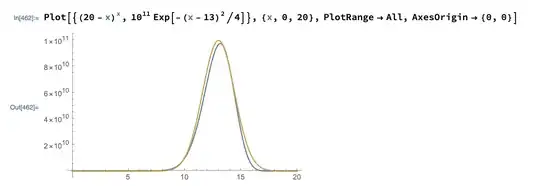

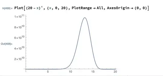

I tried to approximate $ (n - x)^x $ as a Gaussian, look at how close it is visually, but the manipulation escapes me.
Here is the case where $n=20$:

Partial answer: $(a-x)^x= Ae^{-(x-b)^2/c}+O(|x-b|^3)$
Taking logs $$x\ln(a-x)=\ln A-(x-b)^2/c$$
Let $x=b+y$, then expanding out gives $$b\ln(a-b)+y\ln(a-b)-\frac{b}{a-b}y-\frac{1}{a-b}y^2-\frac{b}{2(a-b)^2}y^2+O(y^3)=\ln A-\frac{y^2}{c}$$
Comparing the terms we need $$\ln A=b\ln(a-b),$$ $$(a-b)\ln(a-b)=b,$$ $$\frac{1}{c}=\frac{1}{a-b}+\frac{b}{2(a-b)^2}=\frac{2a-b}{2(a-b)^2}.$$ These determine $b,A,c$ for the best fit.
Checking with the example $a=20$, gives $b=13.16$, $c=-3.49$, $A=9.7\times10^{10}$.
This suggests we take $A\sqrt{\pi c}=\sqrt{2\pi}\frac{(a-b)^{b+1}}{\sqrt{2a-b}}$ as the approximation of the sum.
