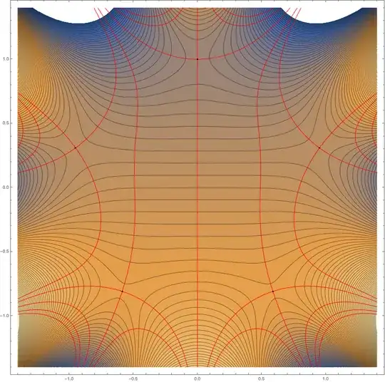

Now to work out which of these saddle-point is relevant, a diagram is worth $10^3$ words:
A plot of the real part of s, with paths of steepest descent marked.
This plot shows (for $n=3$) the real part of $s(z)$, with saddle-points marked in black. Blue colours indicate regions where the real part is more negative. The red curves are contours of constant imaginary part of $s(z)$: the paths of steepest descent follow such curves. With this picture, you can convince yourself that the contour along the real axis should be deformed to pass through all the saddle-points in the upper half-plane, namely $k=1,2,\ldots,n$.
