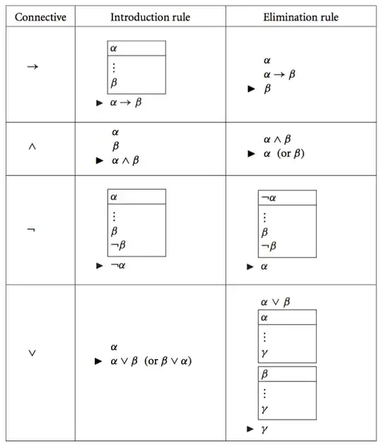

I'm currently learning natural deduction and here is my question.
Is it possible to prove this
$\vdash \neg(P \land Q)\rightarrow (\neg P \lor \neg Q)$
without referring to the law of excluded middle ?
More precisely, using only the following set of inference rules. These rules are being introduced in the book logic: the laws of truth Page 410.
I assume these rules are complete and have tried a long time , however, still cannot come up with a correct derivation without referring to the law of excluded middle which is not included in the following rules. enter image description here

As I already commented on the original post, the (misleadingly named) $\neg$-elimination rule of the calculus is really the rule of proof by contradiction, which is equivalent to the double-negation elimination rule $\neg\neg\alpha\vdash\alpha$, and implies the law of excluded middle $\vdash\alpha\lor\neg\alpha$.
Try to assume $\neg(P\land Q)$ and $\neg(\neg P\lor\neg Q)$, and derive a contradiction. (The most direct way is probably to derive $P\land Q$ from $\neg(\neg P\lor\neg Q)$.) Then infer $\neg P\lor\neg Q$ by the $\neg$-elimination rule, and $\neg(P\land Q)\to\neg P\lor\neg Q$ by the $\to$-introduction rule.
Good answers, here. FWIW, here is a possible proof using Fitch-style natural deduction system and the rules present in the book "Logic: The Laws of Truth".
$ \def\fitch#1#2{\quad\begin{array}{|l}#1\\\hline#2\end{array}} \def\Ae#1{\qquad\mathbf{\forall E} \: #1 \\} \def\Ai#1{\qquad\mathbf{\forall I} \: #1 \\} \def\Ee#1{\qquad\mathbf{\exists E} \: #1 \\} \def\Ei#1{\qquad\mathbf{\exists I} \: #1 \\} \def\R#1{\qquad #1\,(\mathbf{RI}) \\} \def\ci#1{\qquad #1\,(\mathbf{\land I})\\} \def\ce#1{\qquad\mathbf{\land E} \: #1 \\} \def\oi#1{\qquad #1\,(\mathbf{\lor I}) \\} \def\oe#1{\qquad\mathbf{\lor E} \: #1 \\} \def\ii#1{\qquad\mathbf{\to I} \: #1 \\} \def\ie#1{\qquad\mathbf{\to E} \: #1 \\} \def\be#1{\qquad\mathbf{\leftrightarrow E} \: #1 \\} \def\bi#1{\qquad #1\,(\mathbf{\leftrightarrow I})\\} \def\qi#1{\qquad\mathbf{=I}\\} \def\qe#1{\qquad\mathbf{=E} \: #1 \\} \def\ne#1{\qquad #1\,(\mathbf{\lnot E})\\} \def\ni#1{\qquad #1\,(\mathbf{\lnot I})\\} \def\IP#1{\qquad\mathbf{IP} \: #1 \\} \def\x#1{\qquad\mathbf{X} \: #1 \\} \def\DNE#1{\qquad\mathbf{DNE} \: #1 \\} $
$ \fitch{}{ \fitch{1.\,\lnot(P \land Q)}{ \fitch{2.\,\lnot(\lnot P \lor \lnot Q)}{ \fitch{3.\,P}{ \fitch{4.\,Q}{ 5.\,P \land Q \ci{3,4} 6.\,\lnot(P \land Q) \R{1} }\\ 7.\,\lnot Q \ni{4-6} 8.\,\lnot P \lor \lnot Q \oi{7} 9.\,\lnot(\lnot P \lor \lnot Q) \R{2} }\\ 10.\,\lnot P \ni{3-9} 11.\,\lnot P \lor \lnot Q \oi{10} 12.\,\lnot(\lnot P \lor \lnot Q) \R{2} }\\ 13.\,\lnot P \lor \lnot Q \ne{2-12} }\\ 14.\,\lnot(P \land Q) \to (\lnot P \lor \lnot Q) \ii{1-13} } $
