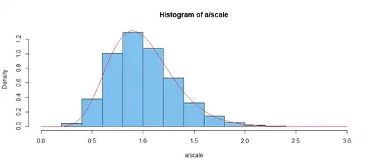

  • If you're estimating the mean μ of a normal population with mean μ and SD σ, then you might take the mean $\bar X$ of n obs. to estimate μ. Then the dist'n of $\bar X$ is normal with mean μ and SD $\sigma/\sqrt{n}.$ Also, $\bar X−μ$ has a normal dist'n with mean 0 and SD $\sigma/\sqrt{n}.$. (No mention of μ.) // Similarly, if you take n obs. from an exponential population with mean λ, then you might use $\bar X$ to estimate λ. But here, $\bar X/λ$ is gamma dist'd with parameters shape=n and rate n. (No mention of λ). – – BruceET Jun 30 '20 at 00:14
Comment continued: Let $n=10; \lambda =\mathrm{scale} = 2.$ Vector a has 100,000 sample averages. Simulation in R.
set.seed(2020);  n = 10;  scale=2
a = replicate(10^5, mean(rexp(n,1/scale)))
 # In R 2nd param = rate
mean(a); var(a)
[1] 1.998913    # aprx E(A) = 2
[1] 0.3998701   # aorx Var(A) = 4/10
mean(a/scale)
[1] 0.9994563   # aprx 1
var(a/scale)
[1] 0.09996752  # aprx 1/10
hist(a/scale, prob=T, col="skyblue2") curve(dgamma(x, n, n), add=T, col="red")
density of gamma with shape=n, rate=n
