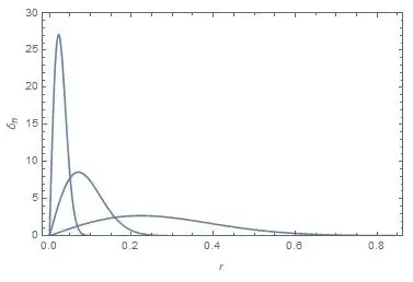

$\def\vr{{\bf r}}$Consider the integral $$I = \int_{\mathbb{R}^d} g(\vr)\delta(\vr-\vr_0)dV_d.$$ (Here $dV_d = \prod_{i=1}^d dx_i$ is the $d$-dimensional volume element in Euclidean space.) A standard delta sequence on $\mathbb{R}$ is $$\delta_n(x)=\sqrt{\frac{n}{\pi}}e^{-nx^2}$$ so $I = \lim_{n\to\infty}I_n$ where \begin{align*} I_n &= \int_{\mathbb{R}^d} g(\vr) \left( \prod_{i=1}^d \delta_n(x_i-x_{i0}) \right) dV_d \\ &= \int_{\mathbb{R}^d} g(\vr) \left(\prod_{i=1}^d \sqrt{\frac{n}{\pi}}e^{-n(x_i-x_{i0})^2} \right) dV_d \\ &= \int_{\mathbb{R}^d} g(\vr) \left(\frac{n}{\pi}\right)^{d/2} e^{-n(\vr-\vr_0)^2} dV_d. \end{align*} Now assume that $\vr_0 = {\bf 0}$ and $g = g(r)$. Then \begin{align*} I_n &= \int_{\mathbb{R}^d} g(r) \left(\frac{n}{\pi}\right)^{d/2} e^{-n r^2} dV_d \\ &= \int_{\textrm{solid angle}} \int_0^\infty g(r) \left(\frac{n}{\pi}\right)^{d/2} e^{-n r^2} r^{d-1} dr \,d\Omega_d & (\textrm{hyperspherical coordinates})\\ &= \Omega_d \int_0^\infty g(r) \left(\frac{n}{\pi}\right)^{d/2} r^{d-1} e^{-n r^2} dr & (\textrm{$g=g(r)$ used}) \\ &= \frac {2 \pi^{d/2}} {\Gamma (d/2)} \int_0^\infty g(r) \left(\frac{n}{\pi}\right)^{d/2} r^{d-1} e^{-n r^2} dr & (\textrm{known result for $\Omega_d$})\\ &= \int_0^\infty g(r) \frac{2 n^{d/2}}{\Gamma(d/2)} r^{d-1} e^{-n r^2} dr. \end{align*} Thus, $$\delta_n(r) = \frac{2 n^{d/2}}{\Gamma(d/2)} r^{d-1} e^{-n r^2}$$ must be a delta sequence for $\delta(r)$. Critically, note that $$\int_0^\infty \delta_n(r) dr = 1$$ for any $n>0$. Also, for $d>1$ we have $\delta_n(0) = 0$ and $\operatorname{argmax}\,\delta_n(r) = \sqrt{\frac{d-1}{2n}} > 0$. This gives us the fruitful intuition that the "spike" for $\delta(r)$ is not at $r=0$, but at $r=0^+$.
For $d=2$ we find $$\delta_n(r) = 2 n r e^{-n r^2} dr.$$ Below we give a plot of $\delta_n(r)$ for $d=2$ and $n=10,100,1000$.
Figure 1. $\delta_n(r)$ for $d=2$ and $n=10,100,1000$.
