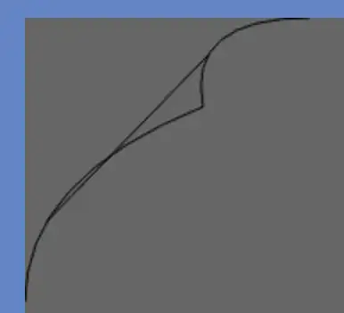

I am trying to find the tangent that is common to two quadratic Bezier curves.
Concretely, I want to draw the corner of a bending piece of paper, like this:
Theoretically it looks simple: Given a Bezier curve $B$ through points $P_0$, $P_1$ and $P_2$, and another one $G$ though $Q_0$, $Q_1$, $Q_2$, i.e.: $$ B(t) = (1-t)^2P_0 + 2t(1-t)P_1 + t^2P_2 $$$$ G(r) = (1-r)^2Q_0 + 2r(1-r)Q_1 + r^2Q_2 $$$$ 0 \leq t, r \leq 1 $$ , I am looking for a solution $(r,t)$ of this system: $$ B'(t) \cdot G'(r) = 0 $$$$ (G(r) - B(t)) = \lambda B'(t) $$ , that is: the tangent vectors are parallel and the vector between the tangent points is on the tangent.
