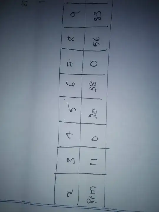

I played around with the general statement
What is the remainder when $x^x-x$ is divided by $x^2+x+1$ where $x$ is an integer.
After trying few valuesenter image description here
I noticed that when $x$ is a multiple if $3$ the remainder is $x^2+2$. As $ 2019$ is a multiple of $3$, we can test $x=2019$ surprisingly I got the correct answer.
