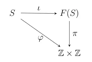

Now let $S=\{a,b\}$, $\varphi(a)=(1,0)$, $\varphi(b)=(0,1)$. By the universal property of $F(S)$, there exists a unique group homomorphism $\pi: F(S)\to \Z\times\Z$ such that the following diagram commutes:
i.e., $\pi\circ\iota=\varphi$. If I can establish the following,
  • $N=\ker\pi$;
  • $\pi$ is surjective, (trivial because $\pi(a^mb^n)=m\pi(a)\oplus n\pi(b)$)
then by the first group isomorphism theorem, the proof is done.
The inclusion $\ker\pi\supset N$ is easy; since $\ker\pi$ is a normal subgroup, it suffices to show that $\ker\pi\supset R$: $$ \pi([a,b])=[\pi(a),\pi(b)]=[(1,0),(0,1)]=(0,0)\;. $$
How can I show the other direction $\ker\pi\subset N$? Or is there anything else I can do to get around this step?
