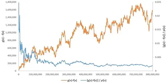

This the data shows that the numbers preceding primes have on a average fewer number of divisors than the numbers succeeding primes. The graph below shows the actual data.

  • @lulu Added a graph which quantifies how large or significant the difference is – Nilotpal Sinha Jun 18 '20 at 05:14
