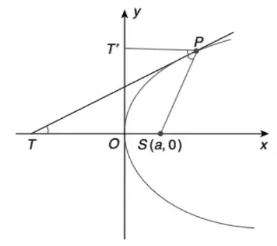

Let us consider the parabola $y^2=4ax$ (or $x^2=4ay$ with $a=1$ as you have done, it's only a matter of convenience), with the point $S=(a,0)$ as focus and $O=(0,0)$ the vertex of the parabola.
Let the tangent at point $P$ (whose co-ordinate has parametric form $(at^2,2at)$) intersect the axis of the parabola, the X-axis in our case, at the point $T$.
Let the line through $P$ parallel to the axis, intersect the tangent at $O$ (i.e. the Y-axis) at $T'$.
The line containing $P,T$ has equation $yt=x+at^2$ $\implies$ $T$ has the co-ordinates $(-at^2,0)$.
Then $\mid ST \mid = a+at^2$ which is also the length of the segment $SP$ (which you can find out from their co-ordinates).
Thus the $\Delta SPT$ is isosceles, giving $\angle SPT = \angle STP = \angle TPT'$ where the last equality holds from alternate angles under parallelism.
Thus we have shown that the tangent at $P$, bisects the angle between the focal radius at $P$ and the line through $P$ parallel to the axis of the parabola, and if the tangent at $P$ bisects this angle ($\angle T'PS$ in this case), then the normal will bisect the supplementary angle, which was asked.
Note that this will hold for any parabola, oblique ones as well, because it is only a matter of reparametrisation.
