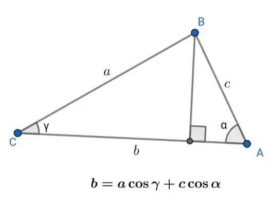

First, let's get the following relationship.
From $$\frac{a}{\sin\alpha}=\frac{c}{\sin\gamma}=\frac{b}{\sin(\alpha+\gamma)}$$
using componendo and dividendo,
$$\frac{a\cos\gamma+c\cos\alpha}{\sin\alpha\cos\gamma+\cos\alpha\sin\gamma}=\frac{b}{\sin(\alpha+\gamma)}$$
$$a\cos\gamma+c\cos\alpha=b$$
However, these are unnecessary stuff since obviously,
Now, let's go back to our problem: deriving law of cosines from law of sines.
From law of sines we have, $$a\sin\gamma=c\sin\alpha$$ Squaring, $$a^2\sin^2\gamma=c^2\sin^2\alpha$$ $$a^2(1-\cos^2\gamma)=c^2(1-\cos^2\alpha)$$ $$a^2=c^2+a^2\cos^2\gamma-c^2\cos^2\alpha$$ $$a^2=c^2+(a\cos\gamma+c\cos\alpha)(a\cos\gamma-c\cos\alpha)$$ $$a^2=c^2+b\cdot(a\cos\gamma-c\cos\alpha)$$ $$a^2=c^2+b\cdot[(b-c\cos\alpha)-c\cos\alpha]$$ $$a^2=b^2+c^2-2bc\cos\alpha$$
$\blacksquare$

  • @Narasimham , sorry I forgot that you are trying to eliminate $\alpha$. I have eliminated $\gamma$ here. But I hope you can do the same for $\alpha$. – ACB Dec 25 '21 at 14:09
    Yes. Thanks for remembering for so long ! – Narasimham Dec 25 '21 at 14:18
    +1. However, it's worth noting that, once you have established $b=a\cos\gamma+c\cos\alpha$, then you effectively already have derived the Law of Cosines: The companion relations, $c=b\cos\alpha+a\cos\beta$ and $a=b\cos\gamma+c\cos\beta$ make for a linear system in $\cos\alpha$, $\cos\beta$, $\cos\gamma$. Solving gives, for instance, $\cos\alpha=\frac{-a^2+b^2+c^2}{2bc}$. There's no reason to "go back" to the problem; you've solved it. :) – Blue Dec 25 '21 at 17:32

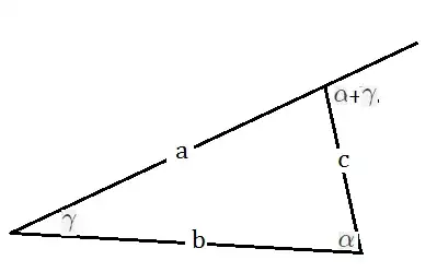

$$\frac {b}{\sin(\gamma + \alpha)}= 2R.$$ $$\frac {b}{\sin(\gamma) \;\cos(\alpha)+ \sin\alpha \; \cos\gamma} = 2R.$$ From Law of Sines: $\sin\alpha = \frac {a}{2R} \;\; and\;\; \sin(\gamma)= \frac {c}{2R}.$
Then $$\frac {b}{\frac{c}{2R} \;\cos\alpha+ \frac{a}{2R} \; \cos\gamma} = 2R,$$ $$b= c\;\cos\alpha + a\;\cos\gamma,$$ $$b= c\;\sqrt{1-\sin^2\alpha} + a\;\cos\gamma.$$
From Law of Sines: $\sin\alpha = \frac{a\;\sin\gamma}{c}.$
Then $$b= c\;\sqrt{1-\frac{a^2\;\sin^2\gamma}{c^2}} + a\;\cos\gamma \;=\; \sqrt{c^2-a^2\;\sin^2\gamma} + a\;\cos\gamma$$ $$(b-a\;\cos\gamma)^2 = c^2-a^2\;\sin^2\gamma,$$ $$b^2+a^2\cos^2\gamma - 2ab\;\cos\gamma = c^2-a^2\;\sin^2\gamma,$$ $$b^2+a^2\cos^2\gamma - 2ab\;\cos\gamma + a^2\;\sin^2\gamma = c^2,$$ $$b^2+a^2(\cos^2\gamma + \sin^2\gamma) - 2ab\;\cos\gamma = c^2.$$
Since $\cos^2\gamma + \sin^2\gamma =1,$ $$b^2+a^2 - 2ab\;\cos\gamma = c^2.$$
