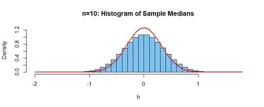

Here is a histogram of sample medians of a million samples of size $n=10.$ The solid red curve shows the density function of the normal distribution of means of samples of size $n=10,$ which is $\mathsf{Norm}(\mu = 0, \sigma = 1/\sqrt{10}).$ [There is also a Central Limit Theorem for sample medians that ensures the histogram is very nearly normal--but with a larger variance.]
hist(h, prob=T, br=50, col="skyblue2",
     main="n=10: Histogram of Sample Medians")
 curve(rnorm(x, 0, 1/sqrt(10)), add=T, col="red", lwd=2)
