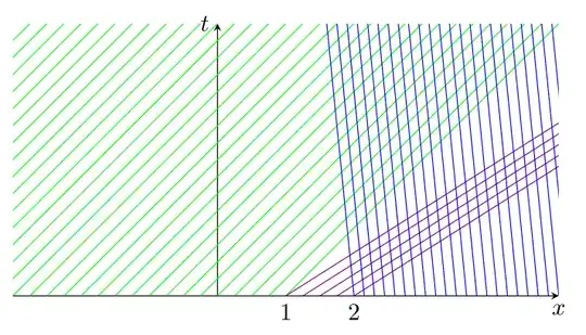

the characteristics:
\begin{center}
\begin{tikzpicture}
\draw[-stealth] (-4,0)--(4,0) node[below]{$x$};
\draw[-stealth] (-1,0)--(-1,4) node[left]{$t$};
\node[below] at (0,0) {$1$};
\node[below] at (1,0) {$2$};
\clip (-4,0) rectangle (4,4);
\foreach \xi in {-8,-7.75,...,0} \draw[green] (\xi,0) -- (\xi+4,4);
\foreach \xi in {0,0.25,...,1} \draw[violet] (\xi,0) -- (\xi+4*1.575,4);
\foreach \xi in {1,1.15,...,5} \draw[blue] (\xi,0) -- (\xi-4*0.1,4);
\end{tikzpicture}
\end{center}

As described in the book, there is a rarefaction starting at $x=0$, and a semi-shock starting at $x=1$. The state $u_1$ introduced in the book is where the semi-shock wave transitions from a discontinuity to a smooth rarefaction wave. See this post for a presentation of these waves.
