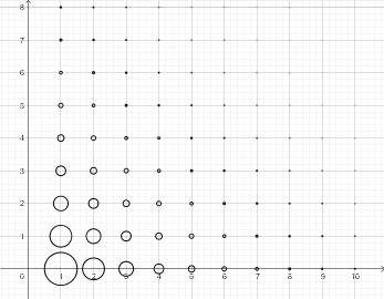

You could utilize one of the well known ways to count the rational numbers, namely consider the integer lattice $\mathbb Z^2$ and the subset $\{(a,b)\mid a\geq 1\ \wedge\ b\geq 0\}$ as illustrated here:
This corresponds to the positive rationals, namely $(a,b)\mapsto\frac ba$. It is a surjective covering and it is now simple to see how we might cover all those points using circles of a finite total area $\varepsilon$ for any given $\varepsilon >0$. In the image above, I have done this using circles of exponentially decreasing sizes, which corresponds to using the well known sum $$ 2=\sum \frac n{2^n} $$ as a finite bound which can then be scaled down ad infinitum.
Thus we can project this representation onto $\mathbb R$ and make a similarly effective covering there.
BTW one way to project this onto the number line $\mathbb R^+$ would be to draw a vertical line at $x=1$. Then given any rational number $q$ one could draw the line from the origin $(0,0)$ through $(1,q)$ and project the circle from the first lattice point this line passes through onto the vertical line $x=1$. This projected circle around $(1,q)$ would effectively translate into an interval around $q$ on the positive $y$-axis (corresponding to $\mathbb R^+$).
