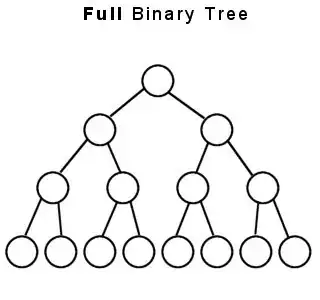

Aside: If you arrange the removed intervals in a full binary tree (like the picture below, but with infinitely many levels), $U$ is the union of the intervals that are left children of their parent intervals, and $V$ is the union of the intervals that are right children of their parent intervals.
